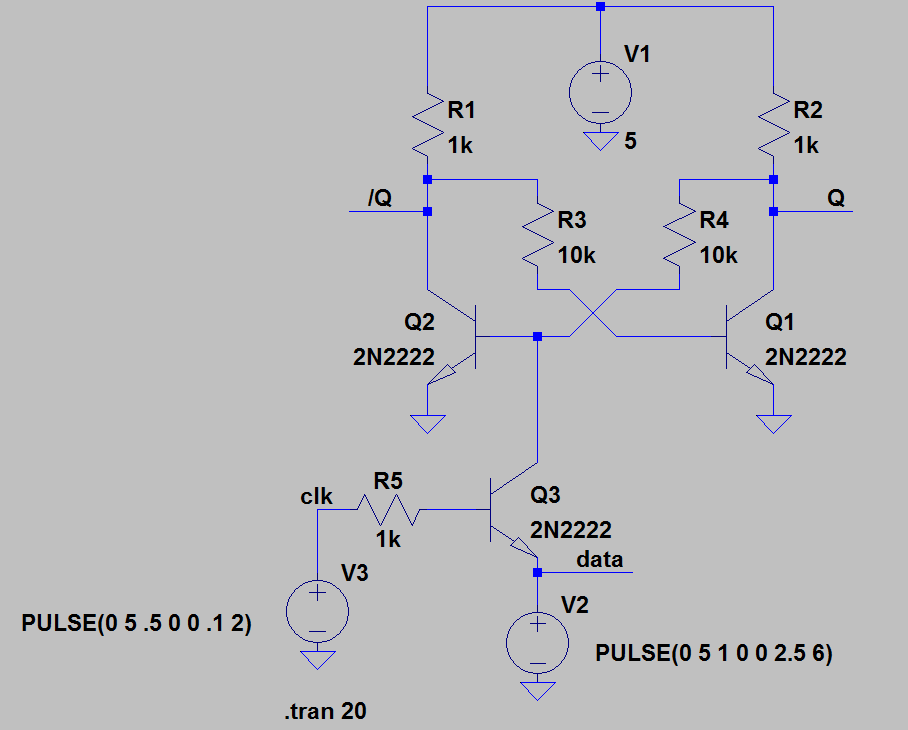

I don't like that circuit.
It's a transparent negative-edge-triggered FF. Here's one I just whipped up that'll work in the same manner as an FF but is obviously less complex.

BTW it is possible to make a SR Flip Flop with two transistors and two resistors, period. Not sure why anyone would want to do this though, unless they want to save an IC chip some day on an already crowded PC board.
That's a neat FF, Dougy. Took me a while to realise it relied on current through the b-c diode of the transistor to clear Q.
