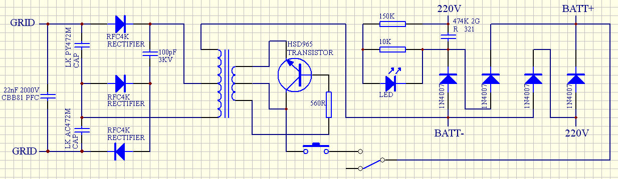

OK to give you guys a hand in helping me, i reproduced the circuit.
I dont have a clue if I have wired the transformer right, all i know is there are three pins on both sides of it. Would that mean both coils are centre tapped?
I just wired it as it looks.
The 474k capacitor on the diode side of the circuit i assume is 470nF with 10% tolerance? Is that right? Its the large green one near the switch on the previous photo.
I dont see how it can use SLA battery, as it gets 240v, it can really only be an electrolytic cant it?
Im annoyed with myself, for such a simple circuit im pretty lost.

Colin55, ive just triple checked it and its the same as the circuit i copied it from, can you pls tell me where i might have got it wrong? As i said before i might have got the transformer wrong, as i have no idea how its wired internally. Im pretty sure the transistor is correct, being an NPN, with pinout 1. Emitter 2. Collector 3. Base.
Get a multimeter set to low ohms or a 6v battery and 330R and LED and measure the transformer.
You have no continuity on the secondary side of the circuit.
You can see how the primary side is capacitor-coupled to the mains, making the primary about 12v - 20v, but the secondary has no continuity.
OK i drew a basic picture of the transformer. It has six pins, but for some reason only four are numbered on the actual transformer.
Four pins are connected together separate from the remaining two, which are also connected together.
As he said originally, he guessed the internals of the transformer. The schematic will now be correct if you move the top of the primary to the top of the secondary.

Original schematic i created
What is connected in transformer when tested with multimeter
Suggested changes to schematic, is this better?
