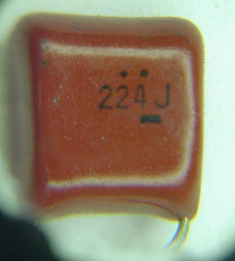

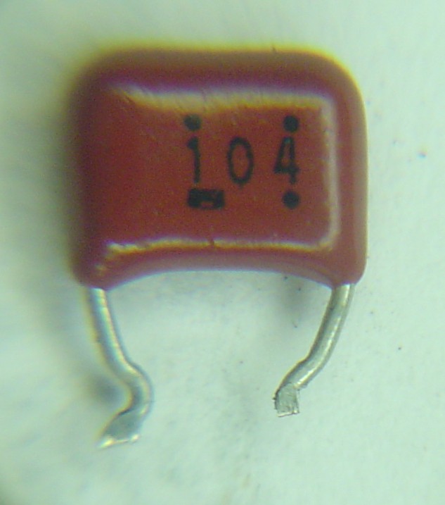

I find a capacitor with this value 474 (0.47 micro farads) , but how i find his rated voltage? y only see some kind of lines and points. (_._.) :confused:
Somebody know the manufacturer to seek the especifications at the official site.
Sorry for bad engllish, my first langiaje is Spanish
my capacitor present the same shape and clolor as the shown on the picture
This is a better pic :D

If it doesn't state a voltage, you can only guess. . . And a guess is just that.
There's no secret, invisible writing. . . And it's not written in the dashes and dots. If it's something you need to replace, then just replace it with a higher voltage rating than you expect it to need.
All electrolytics that I've seen give the rated voltage (in V - volts or WV - working volts=same thing) And you can get ceramics rated at 4Kv, which should be high enough for most applications.
If you're replacing a particular capacitor in a specific piece of equipment, and you're not sure what to use. . . just ask on here, give as much info as possible, and I'm sure the more experienced members will be pleased to point you in the right direction. . .
