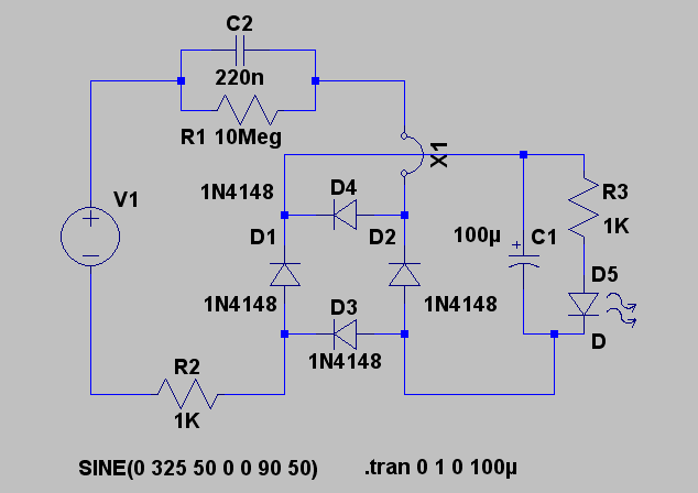

The LED is powered with half-wave so it will flicker at 25Hz and drive you crazy.
Use a rectifier bridge to eliminate the flickering and then a filter capacitor can also be used. The series capacitor that limits the current with its capacitive reactance will then need to be half the value before.

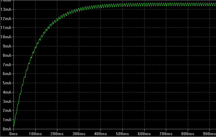

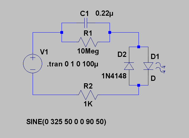

Interesting..
I see.. most of the voltage drop is accross the 10M resistor.. The LED only receives a small portion of the 220V voltage..

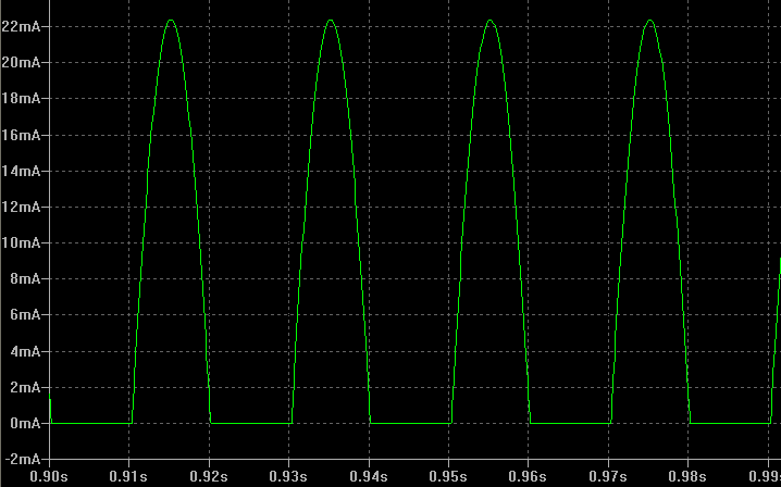

Hmm.. jst wondering.. how about powering the PIC MCU using this method..?
Attaching a full bridge rectifier circuit between the 10M resistor and 1K resistor, 5V voltage regulator and capacitors to smooth the ripples..
What are the disadvantages of that apart from accidentally touching the 10M resistor and high power dissipation..?
Just curious..
C1 needs to be rated for at least 25V.
The power dissipation is actually pretty low, about 300mW.
The apparant power is 3.3VA.
The power factor is very poor at only 0.091. You could improve this but you'd need to add a large inductor which would be very bulky and defeat the purpose of having a light weight power supply.
MrNobody said:
Interesting..
Actually that's not true I believe [for the first diagram]
The 10M has little effect on the circuit, you see capacitors have a resistance to low frequencies, this is called reluctance rather than resistance because unlike resistance no power is dissipated in the capacitor.
The Formula shown below determines the reluctance for a capacitance.
Xc = 1/(2 * Pi * F * C)
Xc = 1/(2*Pi*50*220nF)
Xc = 14.4Kohm
This is in parallel with 10M, because 10M is so high it makes little difference to the resistance.
14.4K + 1K because its in series with the 1K resistor is
15.4K
current = 230 / 15.4 = 15mA
Seems a little low to me.
Edit:Whops I was using RMS value
root(2) * 230 = 425V
425 / 15400 = 21mA.
Thats better :)

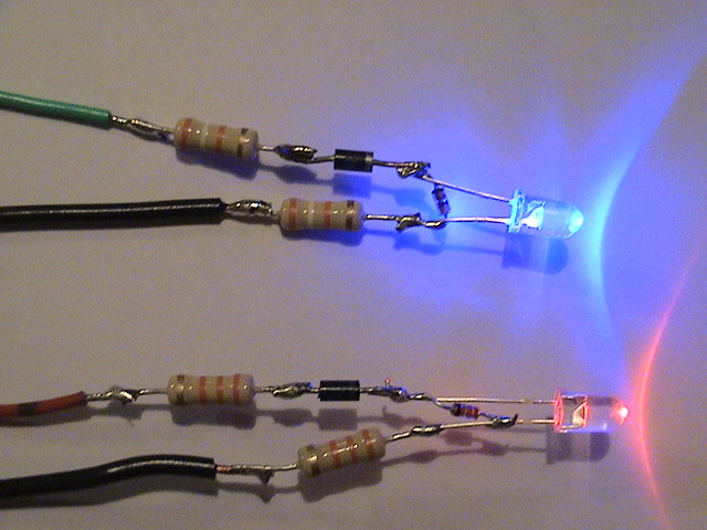

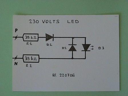

230 Volts LED
I have posted a schema a while back under 230 Volts LED with photo's.
I have used this succesfully for nearly 20 years in industrial metering and indication circuits on power systems 230 / 240 Volts 50 Hz.
D1 - 1N4007
D2 - 1N4148, 1N914
D3 - High efficiency LED
R1 - R2 - 33 or 39 k:ohm: 1 Watt resistor
D1 assisits in reducing the power dissipation in R1 and R2 to 0.7.
To reduce flicker if it bothers you use a bridge rectifier as already suggested.
