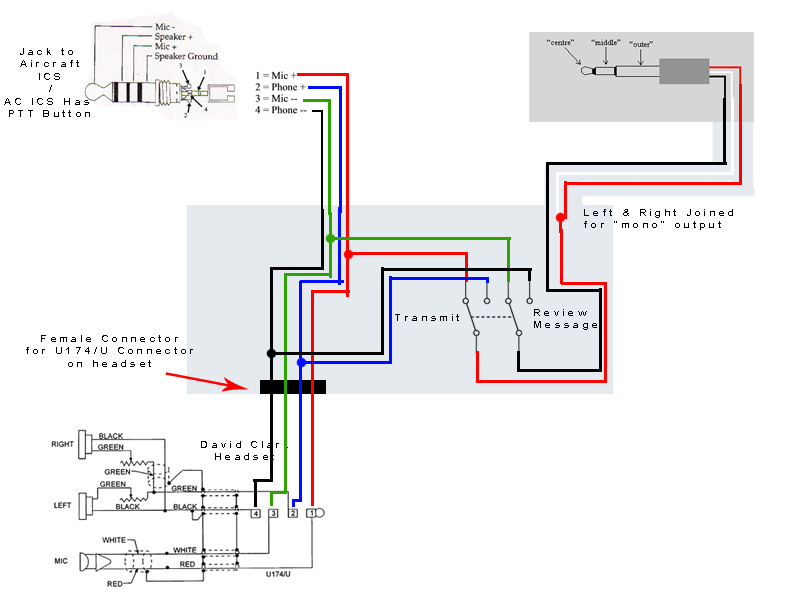

Lets say I have a tape/digital recorder with a preloaded massage that is to be played in a few languages, and it has to be transmitted from an aircraft. So basically I'm trying to make a box that will do the following.
I can plug my digital tape recorder into that will transmit into the Mic.
I can plug my headset into and listen to the tape recorder, to make sure I have the right message before playing, while still maintaining aircraft comms as usual.
Tape recorder uses standard 3.5mm jack.
Aircraft uses the jack in the diagram.
However I would like to have a Switch Installed for TRANSMIT/LISTEN. So as I'm listening it's not feeding back into the AC comms. Will I need a diode to throw in there to only allow the one way direction? But will an, for example, ipod have enough power (.7v) if my memory serves me correctly to bypass the diode?
I know this can be done. I know it can. Am I on the right track with this wire diagram? Any help is greatly appreciated.
