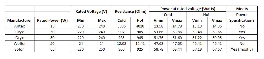

Thought provoking MrAl. So much so that I gathered up all my soldering irons and did a few tests.
I measured the resistance of the heating element, hot and cold, and calculated the power at both maximum and minimum rated supply voltages.
The results are presented in the table below.
The Antex iron is a simple 15watt iron which always surprised me how well it would deal with large joints and chassis connections when the large (6mm) tip was fitted. This iron dates from the early 1970s.
The two Oryx irons are nominally identical and are temperature controlled and adjustable by means of a screw in the side of the handle.
The tips are easily replaceable and I only "retired" this as my everyday iron when the tips wore out and seemed to be unobtainable. I have recently found a source of tips and have a few on order so that I can use the iron out in my garage with out having to come into the house to borrow the Weller.
The Weller is the old faithfull TCP type as used by Audioguru when he installed the sound system on the Ark for Mr Noah.:D
The Solon is a large heavy duty iron for soldering big lumps. The actual iron belonged to my father and probably dates from the 1970s, but, it is identical to an iron which he had in the 1950s which presumably failed at some time.

That's a very comprehensive table there Jim, thanks for posting that.
I can see right away that your Weller 50 watt iron has lower resistance than the ones i've measured. I've measured 16 ohms and yours measures 12 ohms. That's a lot better. The element is replaceable in mine and the element i have right now is stamped with the 50 watt 24v imprint, but it measures 16 ohms. I see your Weller also came in at just under 50 watts, which i think is acceptable. What isnt acceptable is 36 watts. 12 ohms equates of course to 2 amps at 24 volts, so that's about 48 watts which is close to the stamped value, but mine is 16 ohms so it doesnt pull 2 amps so no 50 watts. I did check the Weller irons but they were very expensive for the kind i wanted (like $300 USD).

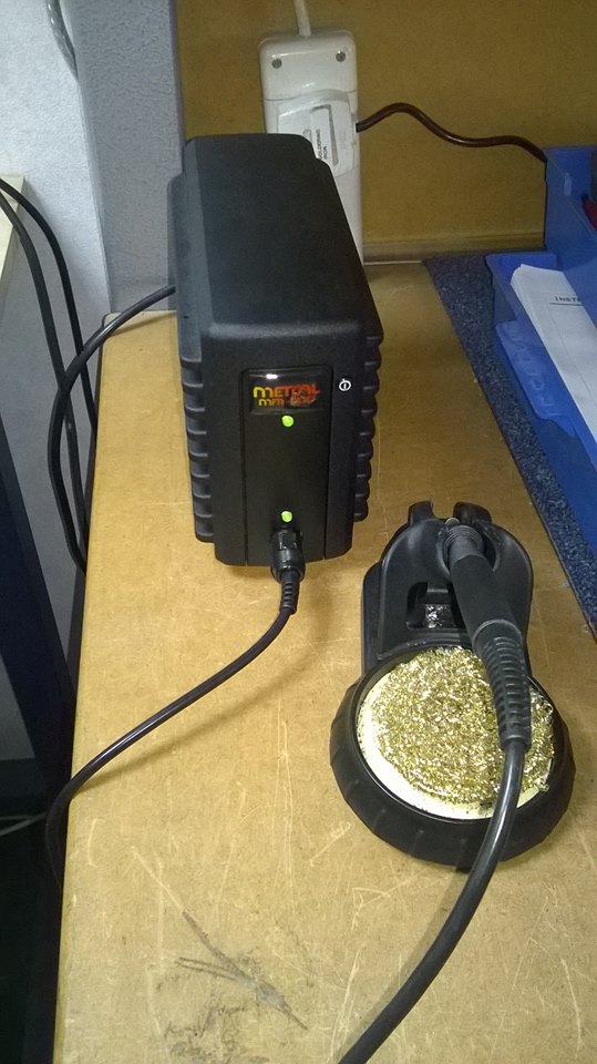

This is what I use. Deceptively small but for its rated 60w will solder just about anything you throw at it.
Not cheap but it was a welcoming "present" from the company I started working for a few months ago :)

Hi picbits,
it looks so nice to handle! Probably it's costly high enough! I have an inron rated just $1. :)
