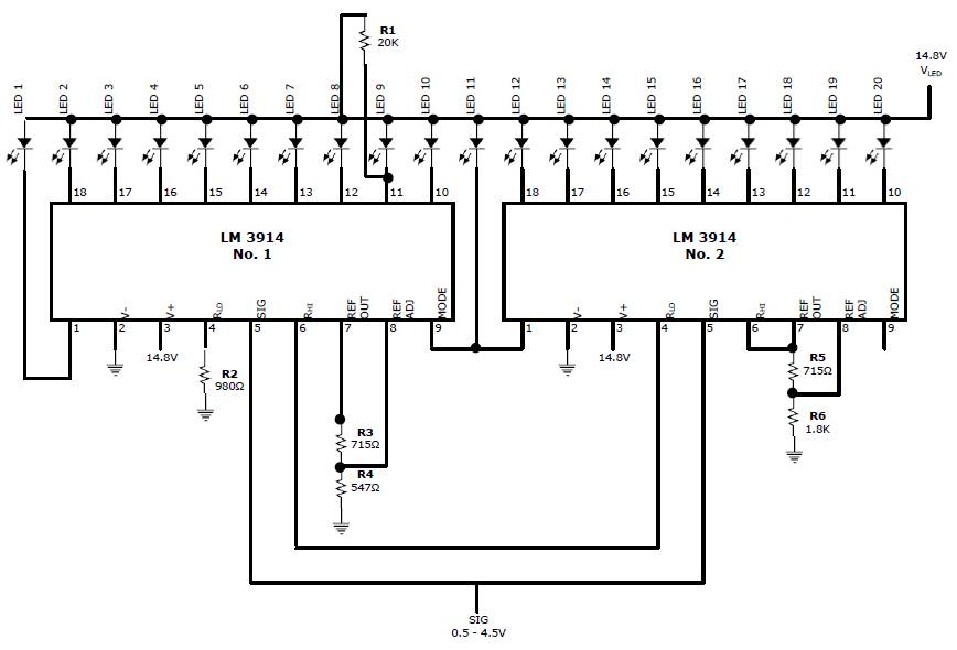

i find in the net this schematic that must be what i was needing about 20 led bar mode ( values of resistors will be changed in my needs )
(click to enlarge)
The pin 9 (mode) in second lm3914 is not connected to nothing ? is this right in this schematic
You saved your schematic as a fuzzy JPG file type so I cannot read the resistor values. If you saved it as a very clear PNG file type then it would be crystal clear.
The MODE pin is disconnected from anything for the DOT mode. It is connected to the positive supply for BAR mode.
You posted it over at PhotoBucket instead of here. Sometimes it takes all day for Photobucket to wake up.
here is the picture my friend

Your LM3914 ICs will get too hot and might melt because the supply voltage to the LEDs is very high and their current is fairly high at about 17mA.
If you use 1.8V red LEDs then the output transistors in the LM3914 have 13V across them and 17mA through them which is a dissipatipn of 0.22W. With 10 LEDs lighted then the heat in the LM3914 is 2.2W. Its absolute max allowed dissipation (when it is very hot) is 1.365W at room temperature and is less at higher ambient temperatures.
The datasheet shows how a resistor can be connected in series with the supply to the LEDs (and a capacitor) to share the heat.
R4 in your circuit does nothing and can be removed.
You need to fix the MODE pins. The datasheet shows a two-LM3914's circuit with a MODE switch.
