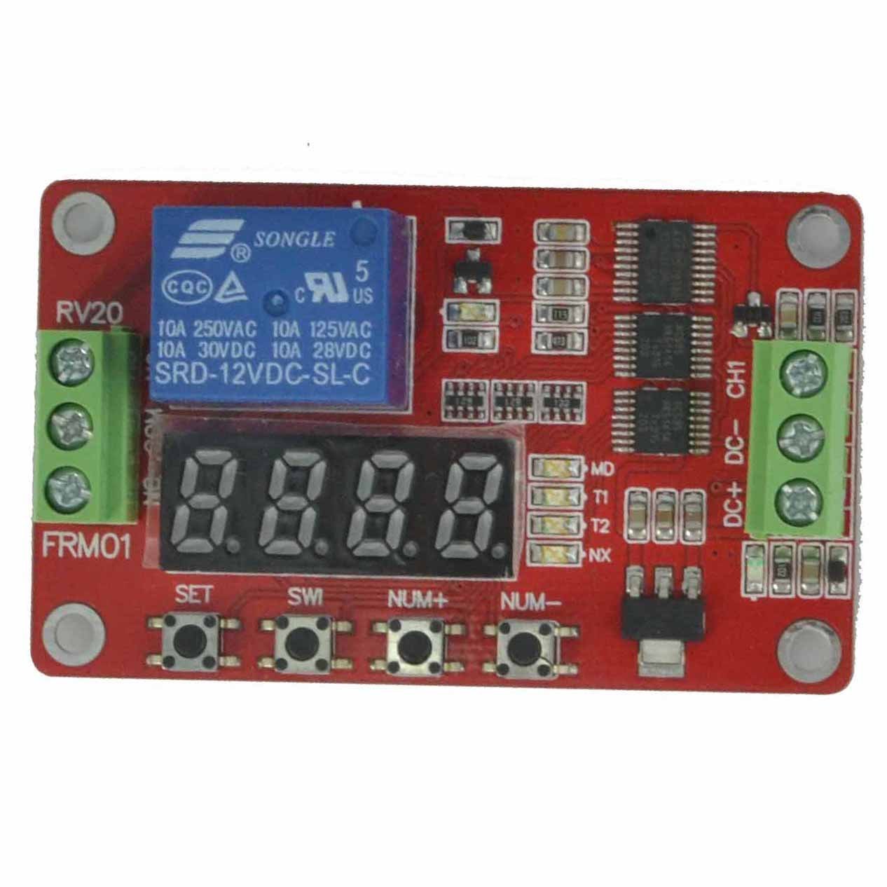

Here is a link to the 2 channel remote 12 volt relay with delay timer:

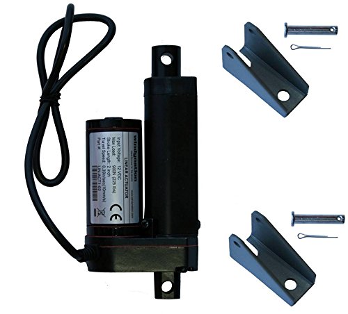

here is the actuator I was referring to:
http://www.amazon.com/Stroke-Actuat...id=1456046831&sr=8-3&keywords=12volt+actuator
I also saw these on amazon as well. It is just a multifunction timer relay but without the remote control:
http://www.amazon.com/Puuli-FRM01-1...&sr=8-1&keywords=12volt+2+channel+relay+timer
Sorry if the pictures are too large. Not sure how to resize them from a link.

However the only thing I cannot figure out is how to auto stop the actuator from continuing once the latch has been fully pushed or pulled.
According to the actuator spec it has built-in limit switches.

My guess is that they are non-adjustable and simply go open-circuit at either end of the stroke. I couldn't see any description of limit switch characteristics. Perhaps you could contact the maker/supplier?
The actuator is a motor-driven lead screw or worm gear drive. It looks like there are only two power leads. There is a limit switch trick that requires two diodes that makes this work, and all of that probably is built in. Connect DC one way, motor runs until it hits one switch, then stops. It moves again only with the DC is reversed, when it runs until it hits the other limit switch. So, your control system needs to be able to reverse the DC polarity to the actuator to get it to move both ways.
If you want a push-push, auto reversing system, then you need a toggle flip flop function somewhere. If you want to wire up something, this can be a couple of transistors, or a single CMOS IC and some driver transistors. If you don't want to wire up something - what is wrong with you??? OK, seriously, you're in luck. An impulse relay does the toggle and power switching all in one part, no soldering.
If you want a more directed control system, with one lock button and one unlock button, that might be doable with the board in post #3.

For the retract use the internal L.S.
For the extend you could fabricate a spring loaded support at the rear end of the actuator, when the actuator strikes the door in the forward motion it compresses the spring and closes a L.S., normally those type of actuators do not back-feed so it should stay that way until retracted.

1 Make the linkage between the actuator and the bolt using a pin engaging with a slot. This will mean that the actuator has to move further than the travel of the bolt. If you make the length of the slot adjustable with sliding plates at each end then you could use the internal limit switches.

Lineear actuators either use a pulse system, non-adj limits or potentiometer feedback.
I never like stalling motors to detect and end stop, I think the L.S. is a better solution.
Max.
Trading electronic effort for mechanical effort, one approach is to adjust the external mechanical environment so the actuator's internal limit switches engage at the necessary positions.

Use channel A to open and B to close. Both on monetary.
Use latching relays that will unlatch with the limit switches.
