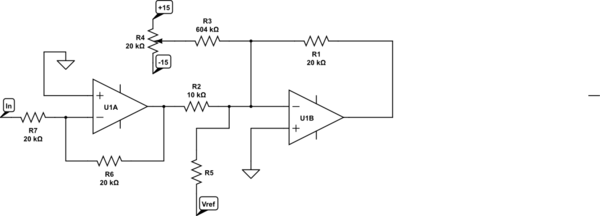

? "Standard" offset nulling circuit for comparators
ci139
Active Member

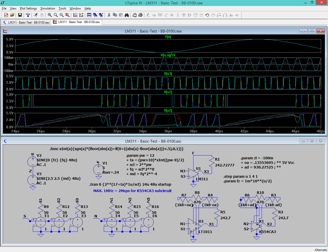

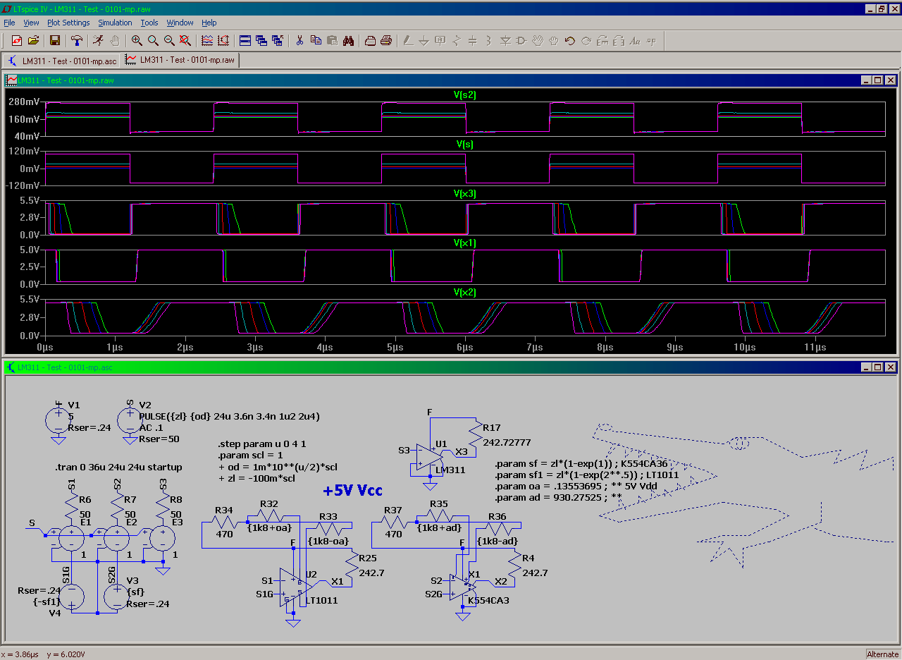

i almost dumped the chips as incapable for low voltage operation
although the d/s -s of LM311 and LT1011 claim the op.-g range should be 3.5÷30V and 3.0÷36V respectively
► at what condition the offset nulling should be done or is it only specific in-circuit ??? -- as it looks the output "zero" depends on supply voltage and OUTP.load values . . . input frequency . . .

a good coverage but does not exactly answer if there is any offset adjust std.-s

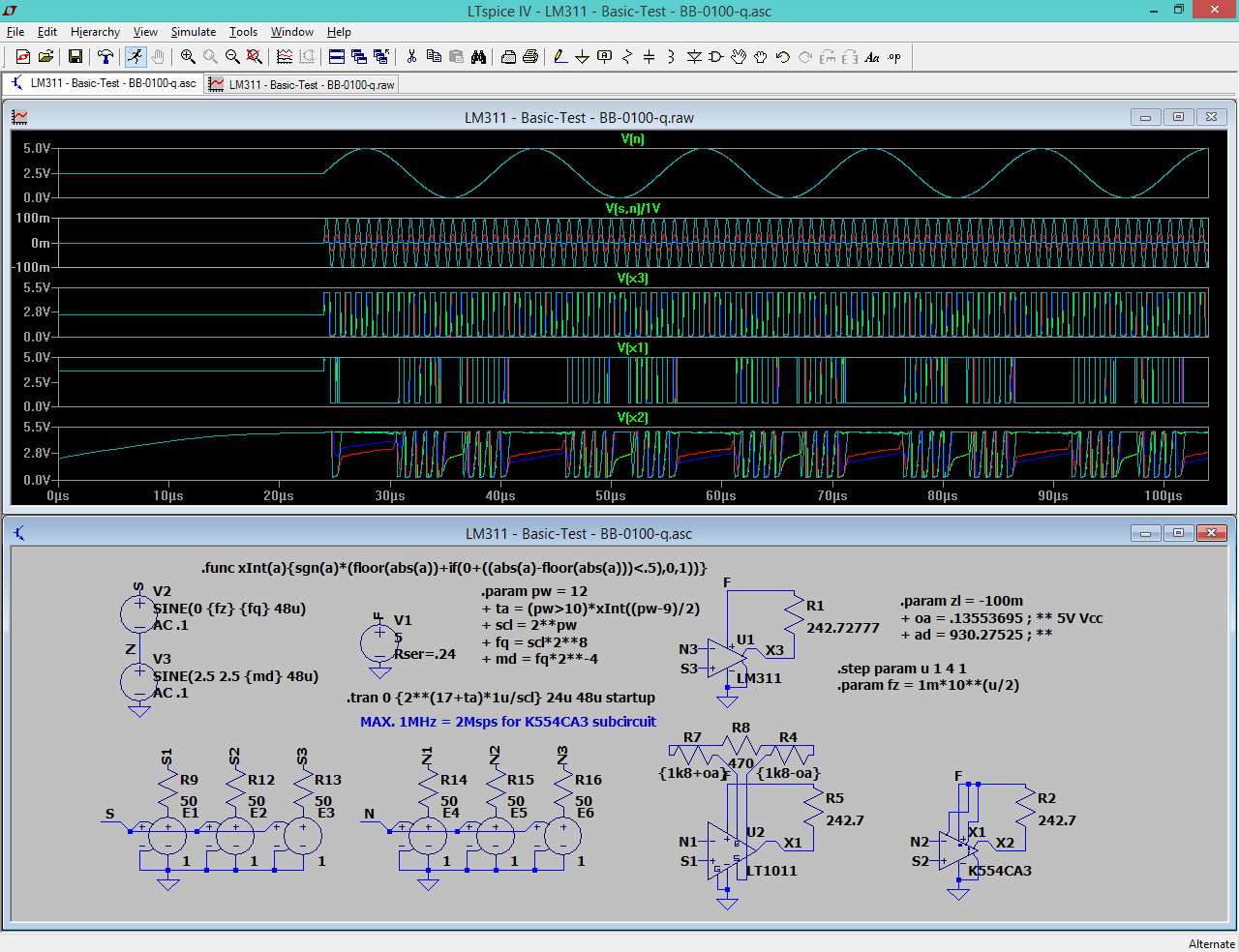

more finds the К554СА3

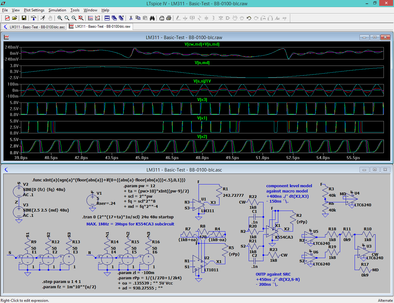

self asking - self answering . . .

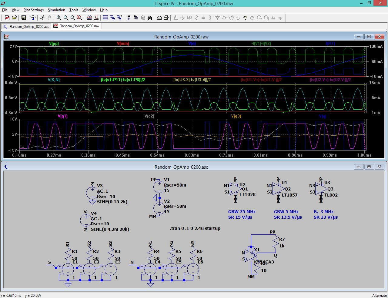

  • i guess these op amp circuits/methods can and somewhat be substituted for comparators
  • there seems not to be standard circuit / -configuration for DC input offset nulling
  • the basic level shift circuit modifications are there what are used for external offset adjustment (not inquired in original question but co-listed here)

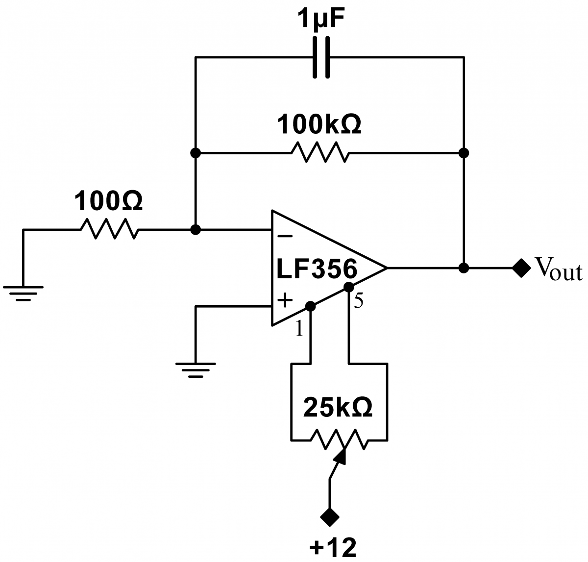

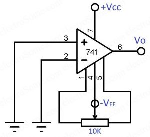

Do you notice that the opamp circuits shown have negative feedback so that they have a reasonably low voltage gain? Then the offset is amplified only by the fairly low gain and the adjustment is easy.
But a comparator has no negative feedback so it amplifies the offset voltage 200,000 times (LM339 and LM393) and it will be impossible to adjust an offset voltage null.
Why do you want to make an offset voltage null? The LM339 and LM393 comparators have a typical offset voltage of only 1mV or 2mV max.

what i want is the "best" setting/bias for comparator to act "most properly" e.g. if both inputs stay near each other - to be able to have a change at the output if theoretically there should be one - simple
For a comparator it is more like input offset compensation rather than nulling, but the idea is the same. That is, to make the inputs appear to be actually equal with actually equal external input voltages (such as 0v but that's only one point). The reason for this is so that the comparator will trip at the more exact voltage level than if it had an offset.
For example, if we need a comparator to trip at 1.000v plus or minus 100uv then 0.001v input offset is too much.
A place where this might be important is in a flash ADC.

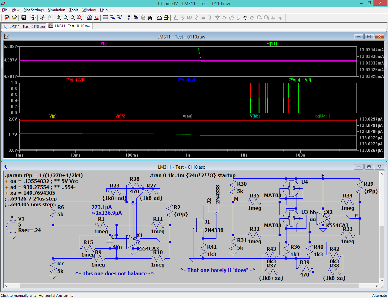

some tests (offset -- don't care assume near ideal Zero)
// the К554СА3 is a substitute for LT1011 or LM311

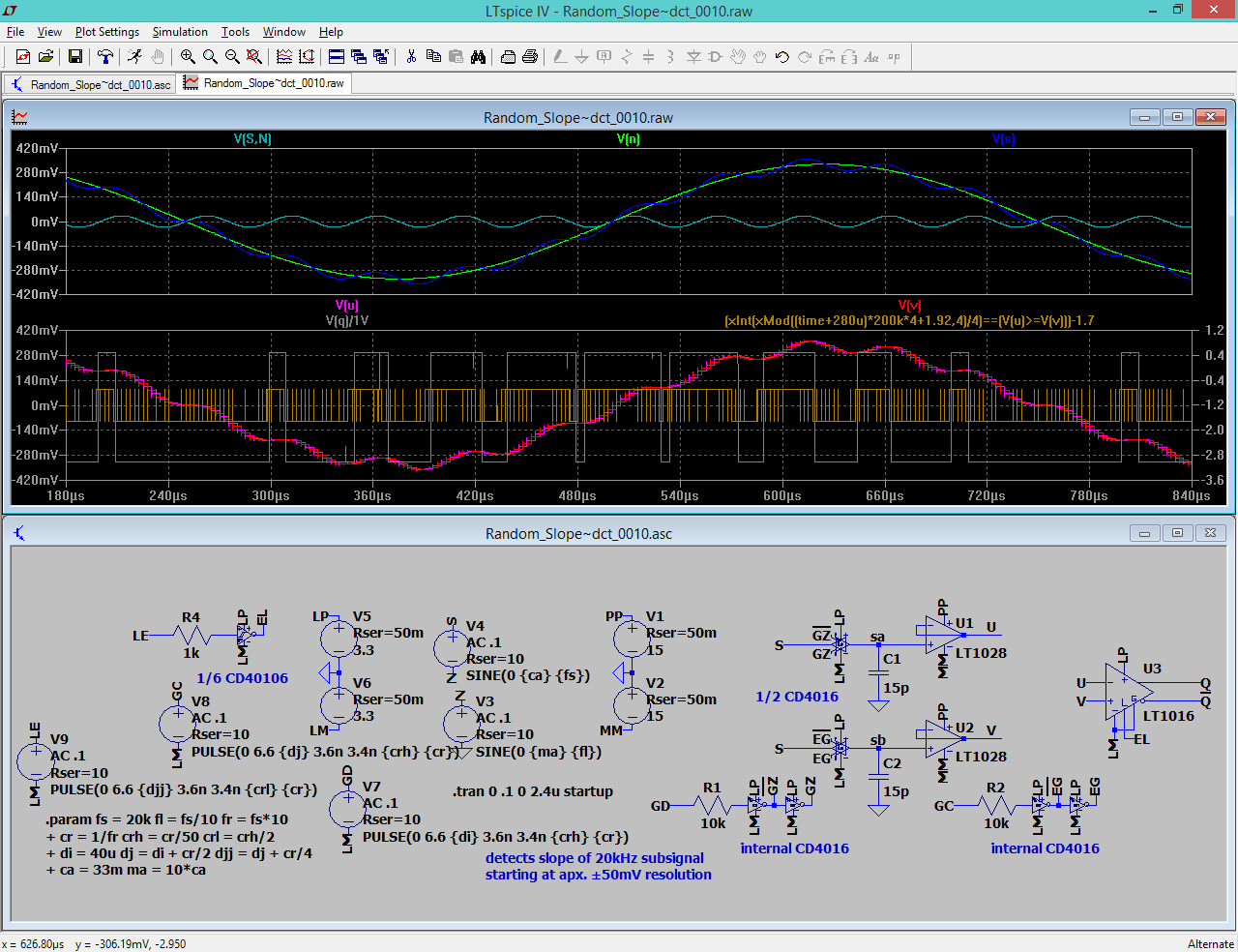

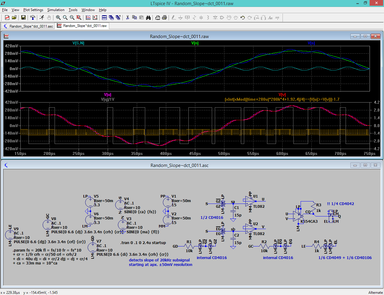

Update 2017-09-02 :: amazingly the LM311 substitute works - it shouldn't - so i yet have to get why how and what it does exactly . . . the bit easier is with TL082 as it does not have to step outside it's slew rate reach to follow that particular analog src. signal
LM311 - Test - 0110.png "External balancing" the K554CA3 (more realistic Spice model of the LM311) using something MAT03

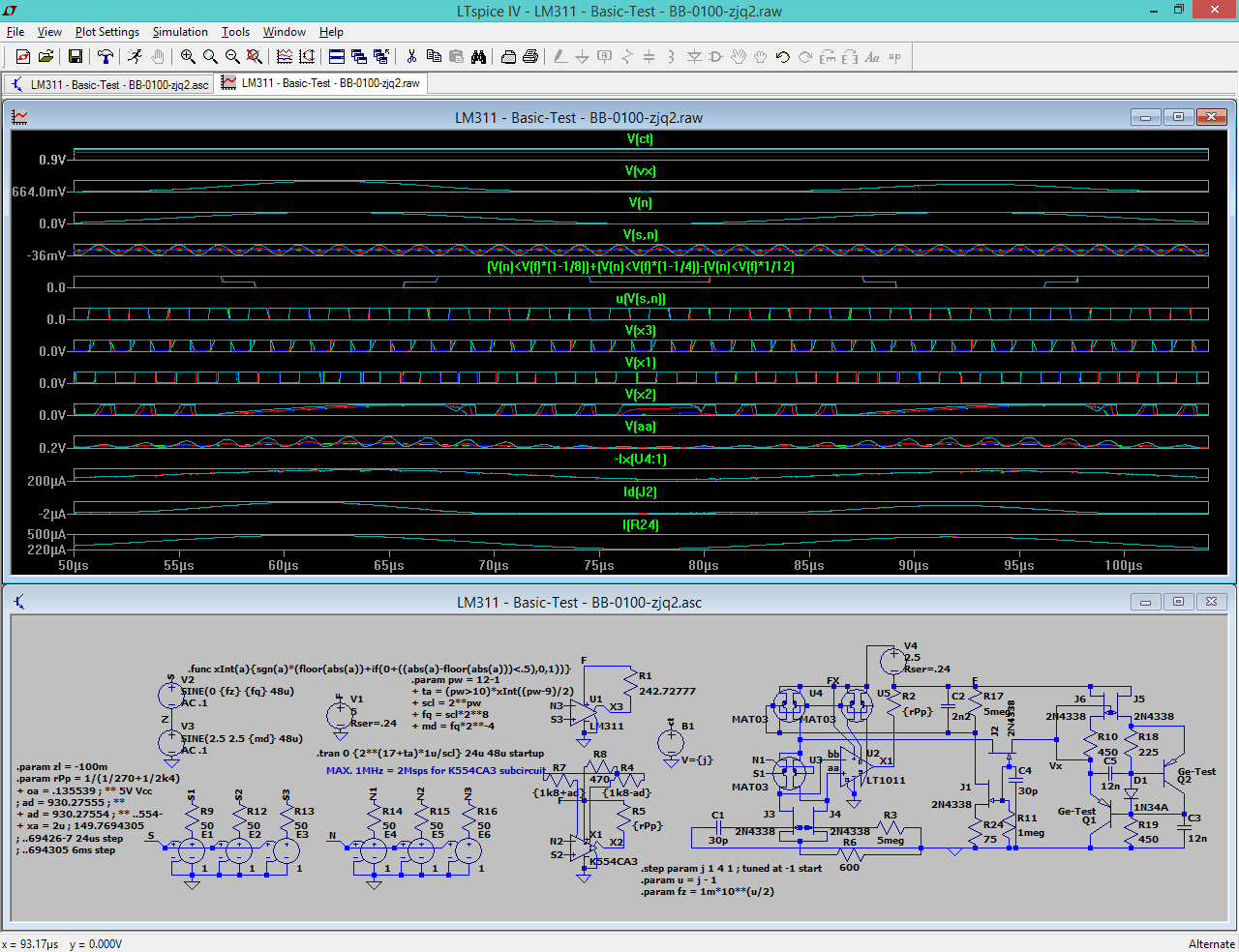

. . . more correct v. with no balancing (can likely be defined using Op amp with similar input stage with similar biasing ? or LM311 with strong neg. feedback ?)
LM311 - Basic-Test - BB-0100-zjq(modified).png LM311 - Basic-Test - BB-0100-zjq2.png
