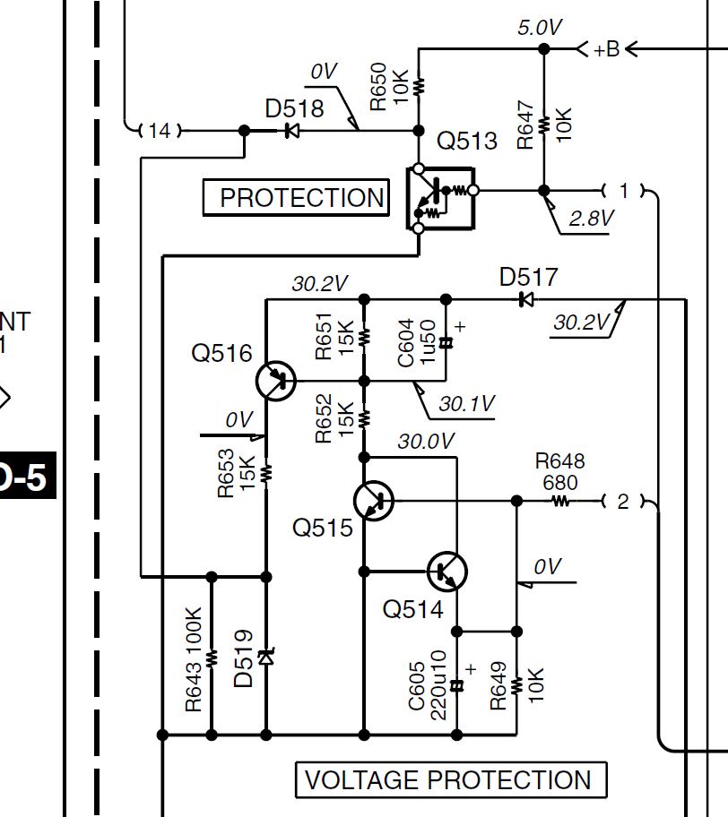

I have attached the service manual, look at p23 and Q515, with the Q515 in place I measure 30v (approx) on all pins BEC it should mesure 30v on B+E as it's a PNP with 0v on C, so I assumed the transistor was faulty, I changed it for a BCX17 but I still get 30v on all pins, with transistor removed I get 14v on B, 30v E, 0v on C and DVR works!

From the schematic the emitter of Q515 should be connected directly to ground so it should never measure 30 volts. Maybe that trace is open?

Hi all,
Just to save anyone downloading th PDF I have attached a screenshot of the circuit, Q516 measures 30v at B & C & E when transistor (old KTA1504 or new BCX17) is in place and B = 14v C = 0v E = 30v when transitor is removed.
After D519 it's 5v as expected (with transistor in place)
hope someone point me in the right direction.

It's hard to tell how this circuit works but it sounds like Q516 would be turned on with the voltages you suggest with the transistor removed. This would imply that Q515 is also turned on (14v @ the base w/o the tx) so you need to trace back from there.

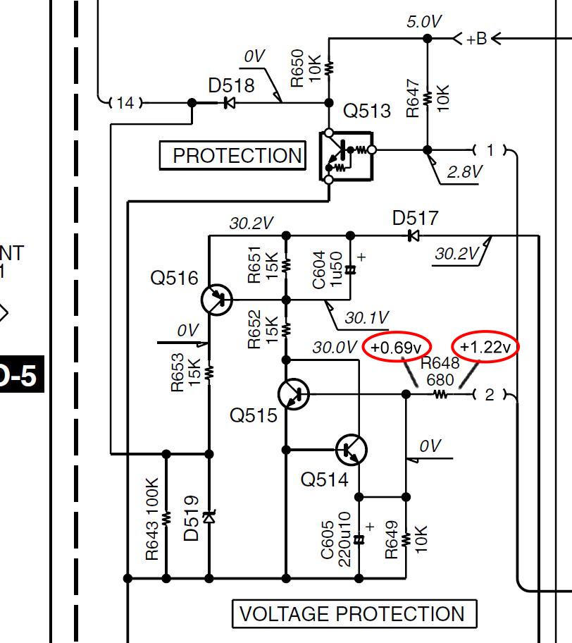

thanks for helping me realise how stupid I was being and why I was getting confused, I have replaced the original KTA1504 (Q516) and measured B+E on Q515, B = 0.70v E = 0.00v, I also measured voltages either side of R648 (see picture)

Q516 will turn on when the base is about .6 lower than the emitter. The thing that gives it away is that you measure 14 volts on the base with the transistor is removed. This says Q515 is on and it's collector at ground. I think if you measure very carefully you will find that the base is about .6 volts (Vbe drop) lower than the emitter and the collector is about .1 volts higher than the emmitter. Check the voltage on the collector of Q515 and the base of Q515 - also on the other side of the resistor that feeds the base of Q515.
Your protection circuit is doing what it should. You have 1.2 volt feeding the base resistor of q515. It should be close to Zero. The 1.2V gives q515 a b-e drop of .7 and this results in a C-E drop of say ~.2 or so, essentially grounding the collector, this then splits 30 volts across the 15k resistors is series, turning on q516 which then gives a c-e drop of ~.2 volt on q516, resulting in 30 volts at the collector.
So you can leave than protection circuit be for now and work backwards to see which amp/s is giving you that 1.2 volts at the base resistor of q515.

Think I have sorted it but thought it wise to run it by you guys, woking back from the overvoltage protection circuit I found that IC503 (AMP) is outputing 2.32v this can also be mesured on AMP side of R625 and 30.24v at AMP side of R624, so I am going to replace IC503, I did not cut any tracks to test these voltages but ironically when first looking at this I suspected IC503 as the signal going into Q510 was behaving different to the other two AMPS (holding at 5v for a lot longer than ther other to AMPs)
