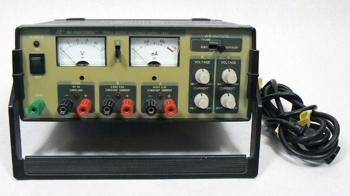

Hi. As for the power supply to use, I suggest you get one something like in the picture. This is a three output supply. It provides a fixed 5V output good for 4 Amps and two variable supplies adjustable from 0 to 24V, 0 to 500mA. The variable current means it will limit the amount of current suppled. When you go over the set amount it will start to adjust the associated voltage downward. This means you get the same amount of power out, but less voltage. When you hit any supply's current limit (4A for the fixed 5V on this unit) a red light comes on.
This particular unit was on Ebay for a starting bid of $20, with $20 shipping. New units from B&K in this category go for ~$450. The seller was an auction house that couldn't say if the unit was working properly, so this may have been a bad buy. That's the way it is on Ebay. I searched using "output power supply". I used "output" because these can be called "multiple output", "multi-output", "triple output" ... a host of possibilities, but "output" is the common term used. They had other units, many from big name companies like Tektronix and Agilent, going up to $250.
