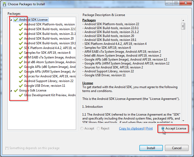

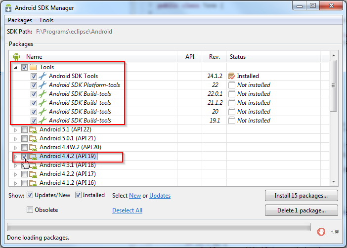

In Eclipse, go to Window-->Preferences-->Android (tab on the left-hand side) and in the SDK Location field enter the installation directory where you installed the SDK. Click "OK". You may get a message saying the SDK Platform Tools component is missing. If you do, go ahead and click "Open SDK Manager" and install all of the items under "Tools". Now would also be a good time to install the packages for the android device you'll be using. I am using Android 4.4.2, so I will check the box next to that item in the manager:
Click "Install packages", accept all licenses (make sure there are all green checkmarks) and click "Install".
Be aware that this installation might take a while. When complete, close the window.

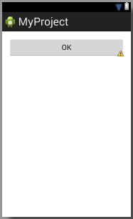

When you create this in Eclipse, chances are the line saying "OK" will be underlined in yellow, signifying a warning. That is because Strings have to be defined in XML files as resources. To fix this, go down to the bottom left of the editor and select the tab that says “Graphical Layout”. This will show you what the screen will actually look like in the emulator. Now, chances are your “OK” button will have a small yellow triangle in the bottom right.
Right-click the button and select “Edit Text”. You should get a window that looks like the following. Click “New String”.
Populate the fields so they look like this image. The first field is the actual text that will be displayed. The second field is the identifier for the new string resource you are creating. When finished, click “OK”, then “OK” again:
And now, when you run your project, you should have a button on your screen instead of the text saying “Hello world!”.
