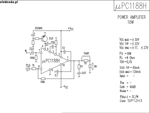

OK here we go UPC1188H

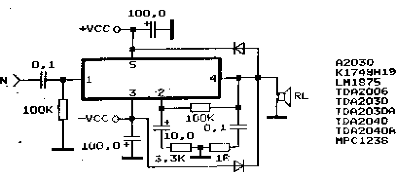

Here we go again.
UPC 1238
10W POWER AMPLIFIER TO220 / 5P
NTE1378 TDA2006 UPC1238 10W A F
uPC1238 - ECG1378
AF Power Out, 10W, Vcc = 12V typ. TO220, 5 pin.
Pin 1: Non-inverting input
Pin 2: Inverting input
Pin 3: -Vcc
Pin 4: Output
Pin 5: +Vcc
