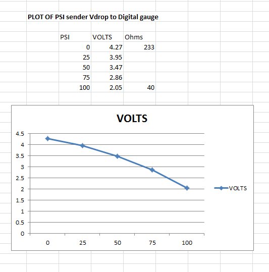

The voltages the gauge sees are: 4.26v @ 0 PSI, 3.45v @ 50 PSI and about 2.05v @ 100 PSI (gauge stops at 99). Getting the 0 and 50 PSI voltages were easy then after fighting to get the 99+ PSI voltage, I thought I would do it mathmatically by: 4.26-3.45= .81 thinking to subtract .81 from 3.45 would give me the voltage for 100 PSI since it was linear, right ?... Not - it was about .59 volts off. I guess I'll stick with building rails..... I fought thru the very very sensitive pot I had and think I got it close for the 100 PSI.

I'll need more points for better mapping, can u get 25psi and 75psi voltages as well pls.

The results are, with relatively good repeatability: 2.05@100, 2.86@75, 3.47@50, 3.95@25, 4.27@0. I also did it in 20 PSI increments starting from 98: 2.2@98, 2.76@78, 3.31@58, 3.71@38, 4.09@18.
I may need a smaller Pot to get better readings as the 2K Ohm is very touchy ! The meter jumps many PSI sometimes with little voltage change. I've checked connections even soldered them to rule out bad connections, then went to a single output power supply to rule out the possible less than perfect pot in the variable voltage power supply.

Ok, given what I see the best accuracy requires a micro controller sampling the voltage, averaging and doing interpolation between the known points on a millisecond time scale.
EDIT. The output drive from the sender to voltage converter will have to sink about 51mA to 'hold' the voltage for the gauge.
It's good to see the voltage vs pressure reading plotted to see a distinct pattern. Interesting solution - I like it.
