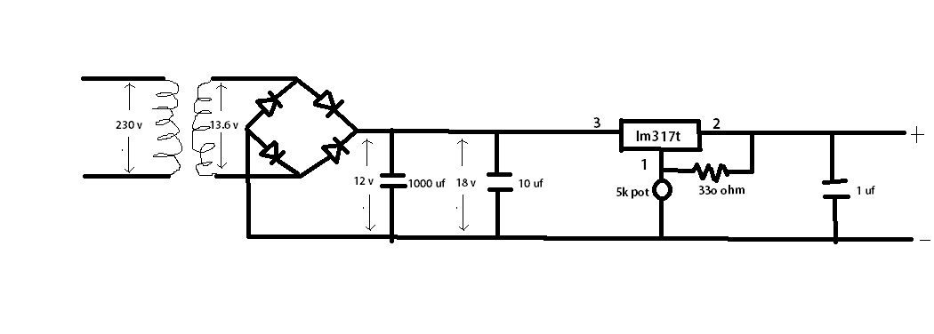

i am using lm317t voltage regulator and my rectifier gives 18 v after a filter capacitor
first time it gives perfect results but from second time in low resistance of 5k pot ,the pot is starting to burn ,and the lm317t is not working correctly until it is being replaced by another one.
i have used 5 lm371t chip and 5 5k pot again and again but it results same .
then i have replaced 5k pot with 1kohm resistance . the resistance is heated up in 2 or 3 seconds
there is no short circuit i have made.
r1 is 330 ohm
please tell me the solution

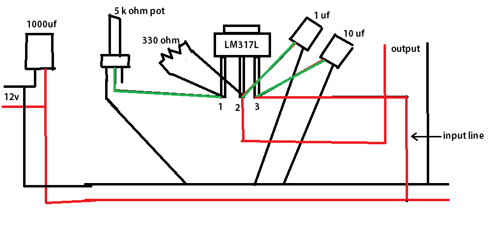

this image shows my config

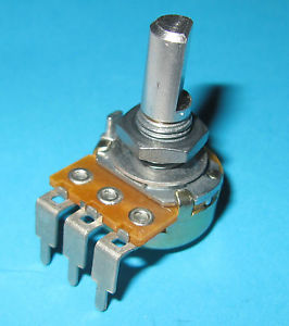

i am using this kind of pot . but when i was using the 1 kohm resistance , it was heated up highly
That pot should be OK.

Could you show in the schematics how do actually connected the pot's terminals?
You may like checking if pin 1 and pin 3 of LM317 are interchanged.
this is what i have done

I believe your 330 ohm is too big. I think it needs to be in the range of 220-240 ohms. Fig 9.2 here https://www.ti.com/lit/ds/symlink/lm317.pdf confirms that. You should have about 1.2 v across the resistor.
If the output is too high, watch for minimum load requirements.
When using a pot in this configuration, the wiper and one end should be connected together.
If this is going to be used as a external variable supply, there are two protection diodes that should be added.

As LM317 voltage regulators are normally fairly well behaved, it looks like you have a major fault somewhere, either a batch of faulty LM317 regulators (already stated) or a wiring error: short for example. You could even have a faulty passive component: resistor or capacitor. Also, as has already been stated, the LM317 may be oscillating. Have you definitely got a positive DC voltage on the input of the regulator?
Incidentally, the current through the potentiometer should be 1.25V/R where R is the resistor connected between the LM317 output and adjust. So for a 120 Ohm resistor the current should be: 1.25V/120 Ohms= 10.4 mA which would be no problem for the potentiometer that you show.
(1) Firstly, as Keep says above, you need to add a rectifier diode for protection: for example 1N400x (where x is any number) cathode to the LM317 input pin and anode to the LM317 output pin.
(2) Also as Keep says, there is a minimum current output for the LM317. This minimum current is 10mA, so the resistor between adjust and output should be 120 Ohms maximum not 330 Ohms. 100 Ohms will be fine.
(3) The length of leads and layout are important (the LM317 is a high gain, high current amplifier) to avoid oscillations. Can you post a picture of your physical circuit?
(4) The type of capacitors are also important for good decoupling. In order of preference, they should be, ceramic, polypropylene metalized film, or low-loss aluminum electrolytic.
(5) Use substantial interconnecting wires- not thin. This is to ensure a low impedance which will help prevent oscillations and also improve voltage regulation.
