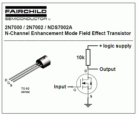

Hi Pradeep,
You can't use a JFET, because it would never turn-off. If you use an NPN transistor, it would need a base resistor and a collector resistor. A 2N7000 enhancement-mode Mosfet would work, it comes in a regular little transistor package and a surface-mount one too, and needs only a drain resistor to be a logic inverter:

So I guess using a NPN BJT is the simplest way out. can anyone suggest which one i should use i have 2N3904/BC548/SL100/2N2222 ? or anyone else. Its been ages since I knew calculating the base/collector resistor values from the alpha/beta/gamma of the BJT :oops: so can someone suggest the resistor values as well :wink:
thanks again :D
pkshima said:
Thank you all for your replies :D
Any small NPN will be fine, from the choices you've given I'd use the BC548, simply because it's a European device.
Resistor values are not at all critical, try 10K for each one!.
