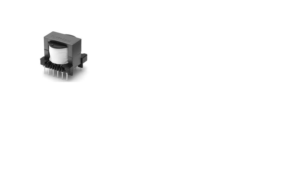

ya, I know it is difficult to get, but you mentioned for thick winding (I guess for high currrent), do you think size can be compact like this shown in the figure if it is made???
30.0× 27.0× 25.5 mm
I doubt there's room on such a small core for 100A wire, but if the core is rated at over 100W you may be able to use multiple thin wires in parallel to make a high current secondary, this is common practice anyway, due to the difficulty of winding thick wires. Another common method is to use copper ribbon, rather than wire.
You might consider looking at an old in-car high power amplifier, these have switch-mode supplies in them, but it really depends on how many windings are used on the primary, it's generally not very many.

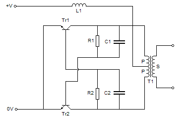

Here's a simple self oscillating push-pull inverter circuit.
If you wind T1 with the correct turns ratio, you can covert 24VDC to 1VAC squarewave which should power the heater with no problem.
I'd recommend using a grossly oversized core for T1, try 200W, just to make it easy to wind thick wire round. I also recommend using copper strip or many thinner copper wires in parallel. I'd be tempted to try desolder braid covered in a conformal coating (before winding) as an insulating material.
