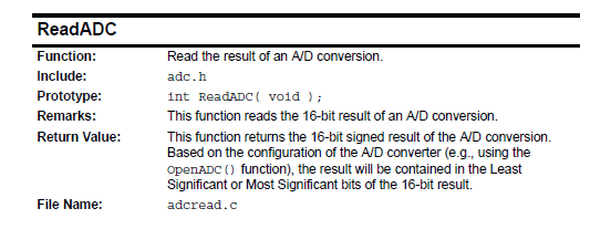

Are you absolute sure that your C compiler does not allow you to read the 10-bit ADC result into an unsigned int in one go?
Many C compilers are able to do just that. User can, but does not need to read both the low byte and high byte and merge them together.
What MCU and compiler are you using?
Added: If you are using C18 Microchip compiler, you just need to include the header file adc.h and then get the ADC result simply by writing h=ReadADC();
