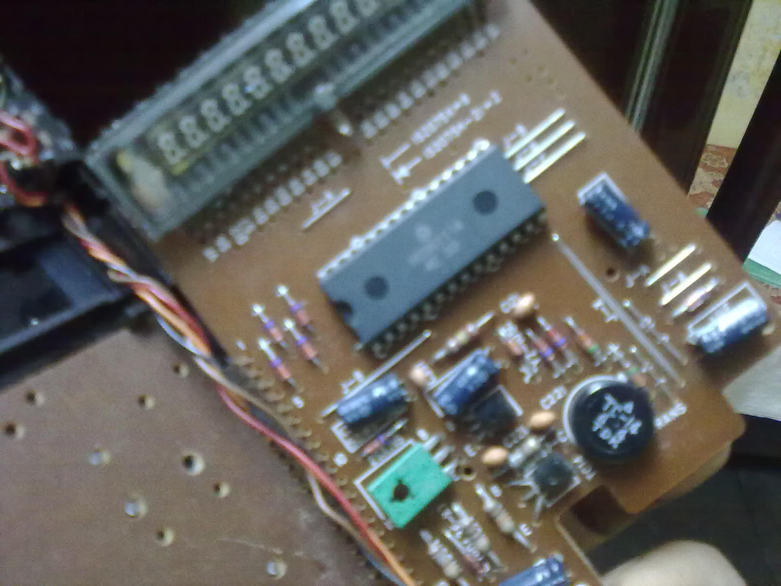

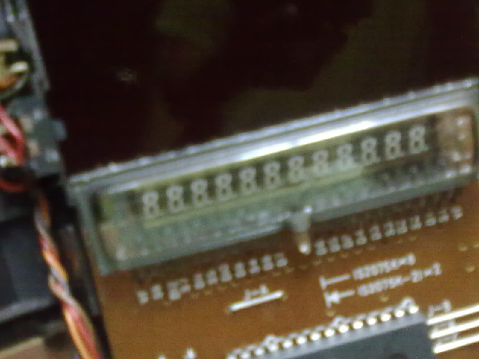

Hi, i got VF from my old Casio calculator it have 10 blue color display the pins are name as
VF S6 D12 S7 D11 S5 D10 D9 S4 D8 D7 D6 D5 DP D4 D3 S3 D2 S2 D1 S1 VF
i think S is for segment, D is for display..., but what about supply connection??
i don't know how to use this displays.
its no. is ld8197a
Here is the image of it.

It's a high voltage VFD display, you'd need something like an old Nixie tube driver to get it lit.
Nixie tube need near by 220V, but this VF were used in small calculator that mean it circuit give high voltage if you tell me about how to give it supply rest of work i can do my self.
