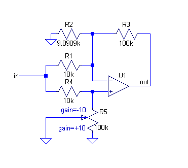

I finally found **broken link removed**. I knew I had seen it somewhere. Below is a slightly modified version that uses a pot to vary the gain.

Thanks Ron H. I was thinking about a modified diff amp but couldn't quite get it.

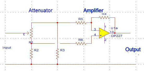

Here is what I had in mind:
The attenuator puts varying amouts of signal to the two inputs of the differential amplifier.
When the two inputs are equal, there is no output (gain = 0).
When there is more signal to the non-inverting input the gain is +Ve.
When there is more signal to the inverting input the gain is -Ve.
Set the amplifier input and feedback resistors to give the required gain, which depends on the attenuator losses and the output required.
I think you're all making this far too difficult?.
As I understood the question, he wanted either a gain of 10, or an attenuation of 10, and fully variable between the two options - which is what I provided, either inverting or not, with one opamp.
The schemes for changing from inverting to not-inverting are flawed, because what happens when you get to the balance point - no output at all!.
Perhaps 'petesmc' should clarify the question further - presumably it's a school question?.
