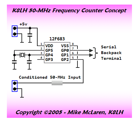

You might consider using Timer 0 with its 1:256 prescaler for a 50-MHz counter and using a high speed divide-by-two counter on the T0CKI input to realize a 100-MHz top end.
You don't need any fancy "gate" hardware to turn the counter on and off. Just toggle the T0CKI pin from an output to an input to start the counter and after a precise period toggle it back to an output to stop the counter. Use a 1000 ohm resistor between signal source and T0CKI pin to absorb the input signal while T0CKI is configured as an output.
Timer 0 is an 8-bit counter on most PICs so you would use TMR0 register value for the middle 8 bits of your 24 bit result and use Timer 0 overflows for the upper 8 bits of the 24 bit result. With a 50-MHz input signal you could expect a Timer 0 overflow approximately every 1.3-msecs so it's important to check for overflow at least that often while counting. Capturing the 1:256 prescaler value and using it for the least significant 8-bits of the 24-bit count is pretty well documented and shown below.
Here's an example excerpt of the most significant portion of a 50-MHz counter program. I hope it gives you some new ideas.
Kind regards, Mike

Hi MikeMl,
Just wondering why you decided on 100-MHz?
I want to go to 1GHz with a decade prescaler, so 100MHz without it. I want 1Hz resolution at 100MHz (more on this later); 10Hz resolution when using the prescaler.

That's a very good example and description of the old Timer 0 derived 50-MHz counter. The front-end signal conditioning looks good too. Now if they had just known how to "gate" the T0CKI input and retrieve the prescaler value all in software they could have saved two pins and replaced IC2:74HC132 with a 1000 ohm resistor.
Regards, Mike
50-mhz-counter-png.34839
