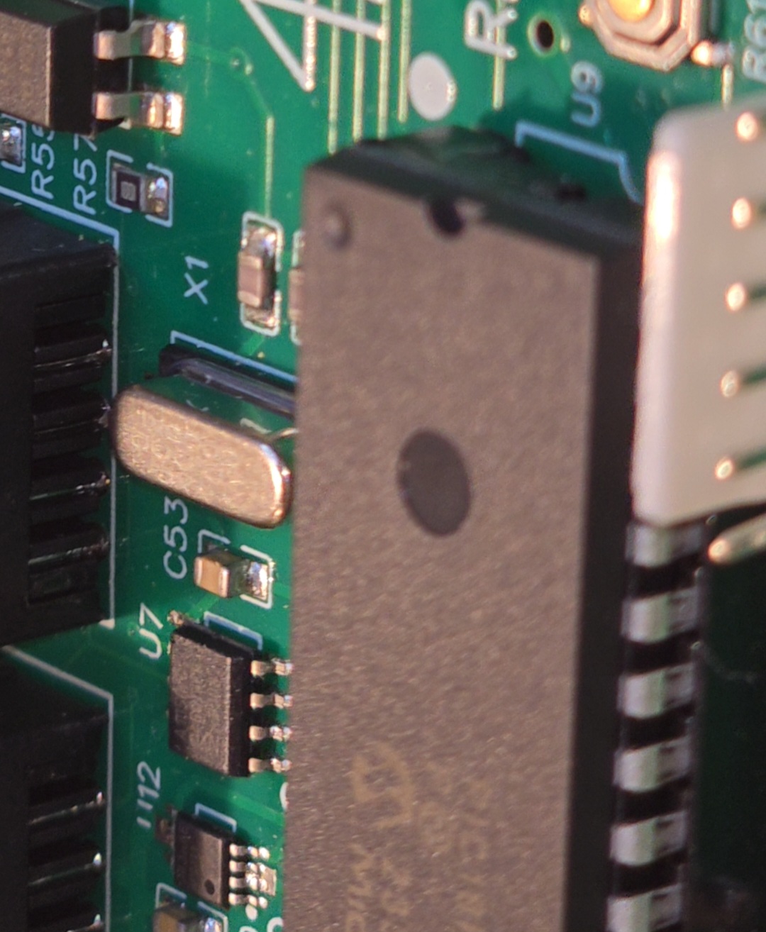

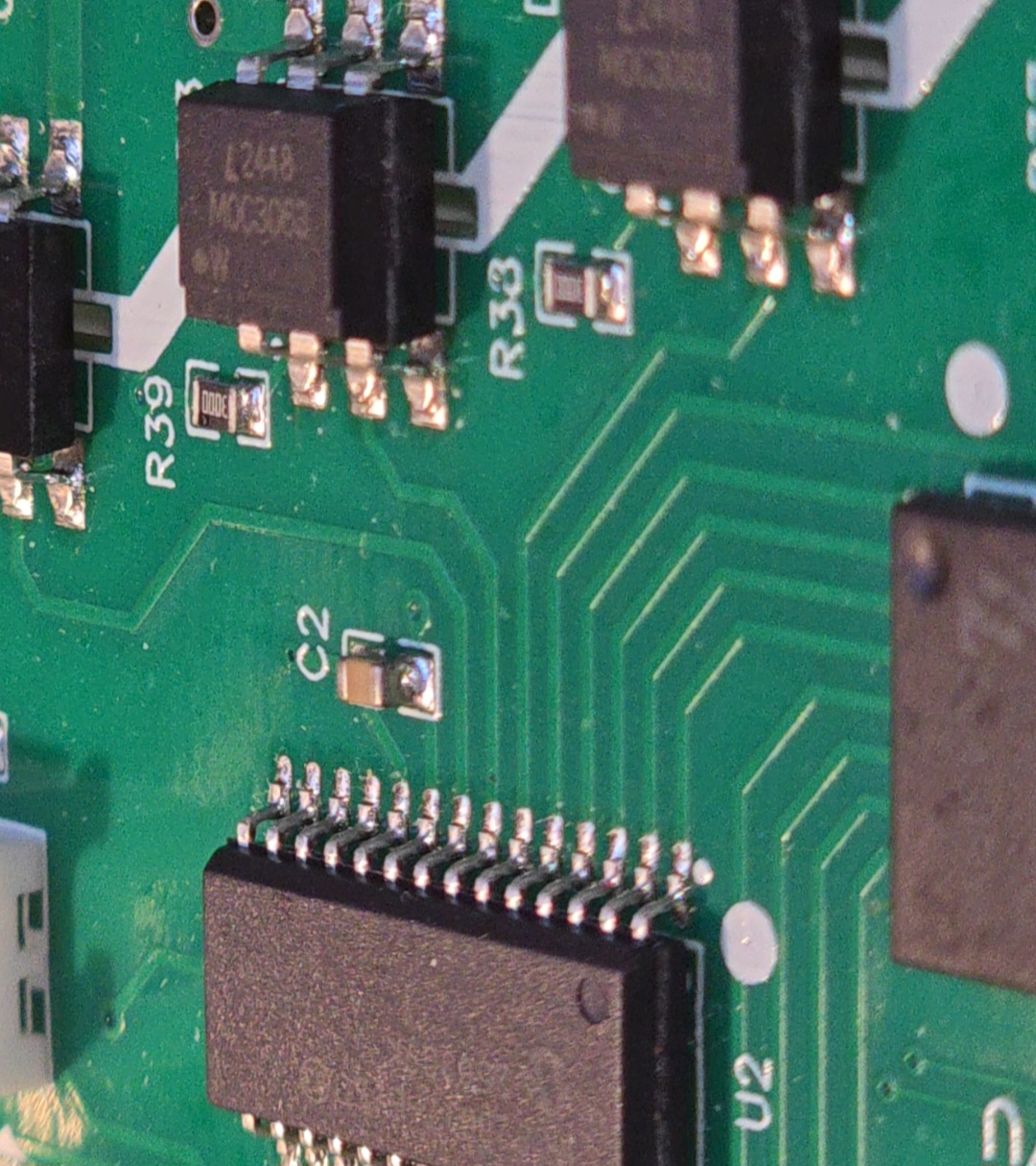

While looking at the board, I noticed my 0805 100nF bypass caps seem unusually thick – they're about as thick as they are wide. I don't have a capacitance meter, but my "component tester" says they are around 130uF, not 100nF. It's possible that my assembler screwed these up.
It doesn't seem like this should matter much, but there are about 10 of them on the board. Do you think this would make a difference? Yes, reaching for straws at the moment....
The caps to the right of the crystal are 22pF, and I expect 100nF (C53 & C2) should be about the same thickness.
Ok, the thickness does check out per the datasheet for 100nF caps.

After looking at the datasheet, the square profile is the right aspect ratio for 100nF in this line of caps – usually they seem to be thinner.

Once again, your experiences and mine may differ. Considerably. I have noticed over the years that fairly large 0805 caps, say 10uF, have a square profile. The stand noticeably taller on a PCB than 100nF or 22pF caps. While these smaller caps may not be the same thickness, in MY experience, they usually do not appear to be square.

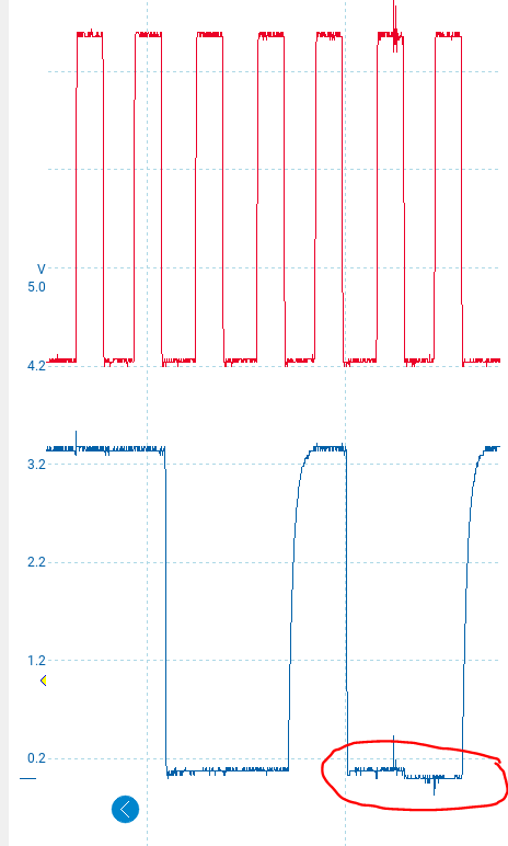

I have never been able to fault-find I²C without an oscilloscope or logic analyser.
Often, on I²C, the low voltage levels are slightly different for the master and slave, which can help when using an oscilloscope.
The different levels can be seen in the bit I've circled.
You can put a small resistor in series with either the master or slave data line to induce a similar effect if the two data connections are too similar to see the difference.
