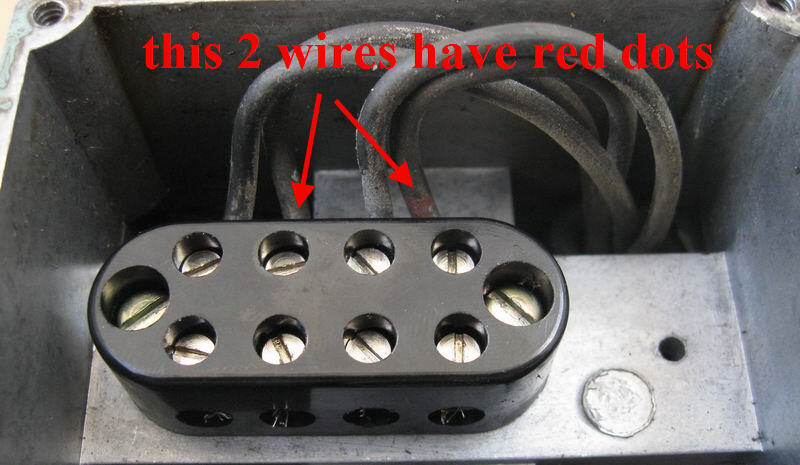

I have 110V dc electric motor with gearbox that I need to connect to power supply.
How to connet to power supply + and - with 4 wires
2 wires are black and have red dots and other 2 wires are black
Thanks for any help

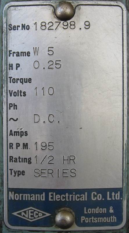

This looks like a shunt wound motor.
I am not sure about that Les, have a look at the rating plate where it clearly states "SERIES".
It would be helpful if Jurilica could measure the resistance between the connectors.
If this is a shunt wound motor, the field winding resistance will be much higher than if it is series wound.
Hi Jim,
You are right. I foolishly looked at the low speed on the label and made the assumption that it was a shunt motor. I had missed the fact that it was a geared motor. Two of the wires will go to the brushes and two will go to the field coils. The field coils will probably have a lower resistance than the armature.With your multimeter identify the wires. Connect the wires that go to the brushes in series with the wires that go to the field coil and connect the two free ends to your 110 volt DC supply. (The polarity does not matter.) If you want to reverse the motor reverse the connections to either the field coils or the brushes. (But not both.) Thanks again Jim, The information I posted would have burned the motor out.

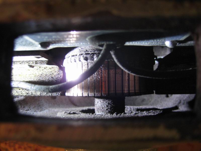

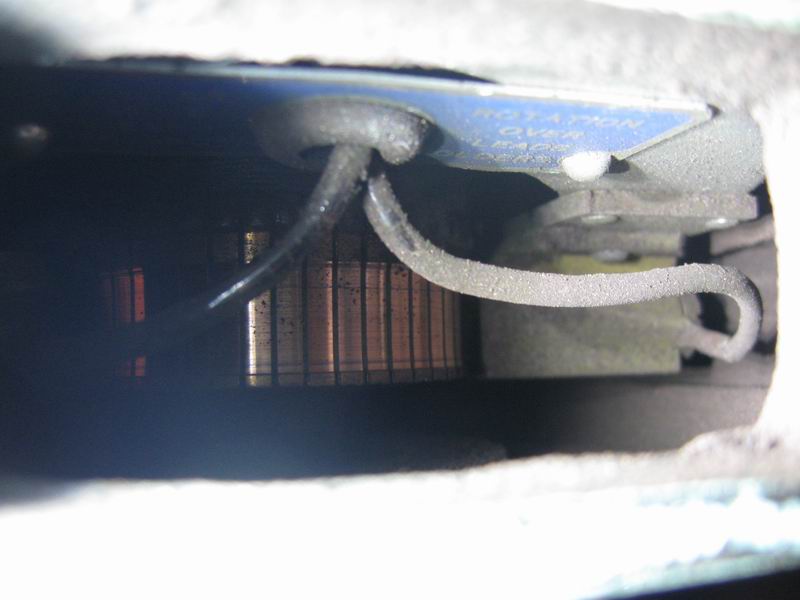

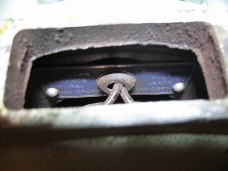

I remove some plates from motor and took pictures, maybe this help.
To alter rotation change over these leads on brush holders
Does it mater color of wires, from left to right
black - black with red dot - black - black with red dot

You need to identify the two pairs of wires that show continuity between them with your multimeter or identify then by tracing where they go to inside the motor. I have no idea of the significance of the red dots.
Les.

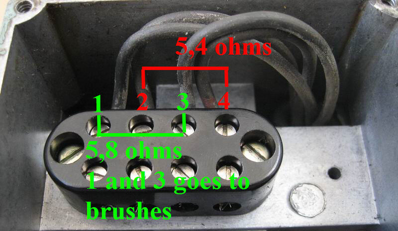

Can this help
I think than confirms that this is a series motor.
The field winding has a resistance of about 5 Ohm, if that were connected across 110v DC there would be a current of 20 amps or so flowing, and a smell of burning wires!
So to make the motor run correctly, connect terminal 2 to terminal 3, and connect the 110v supply to terminals 1 and 4.
Do you agree Les?
Hi Jim,
Yes I agree. It's a good job that you spotted my error before jurilica. connected it up the way I suggested in post #2.
Les.
The plate states Series.
That appears to be an Extremely low RPM (195 rpm) for a Series motor unless it has a reduction of some kind.

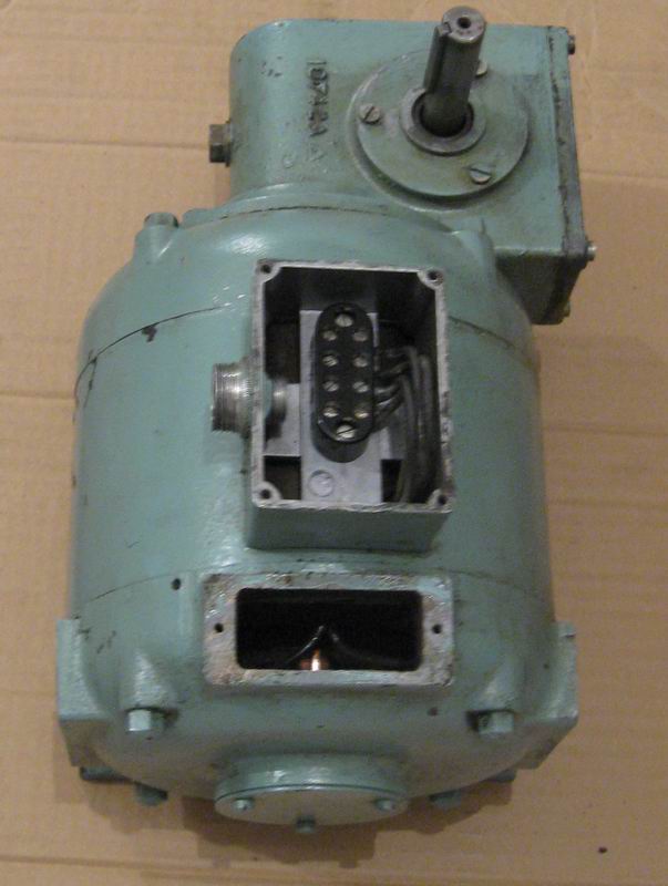

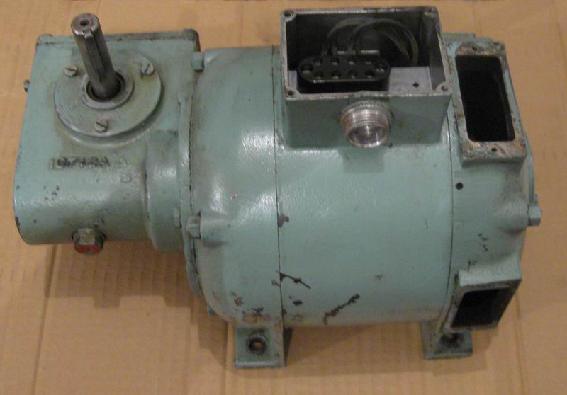

Pictures of electric motor with gearbox

How do you intend powering it? In theory it should also run on AC.
But if there is a 110/120vac supply where you are you would just need a bridge rectifier, a 10a or 20a would be more than sufficient.
Max.
Yes it should run on that, often these motors have simple variable Triac control off of AC.
With a bridge for the motor if DC.
Max.
Hi Max,
If the core of the field coils was made of a solid piece of metal rather than laminations the motor would probably not work well on AC due to eddy currents in the core. If the core is laminated I can't see why it should not work on AC.
