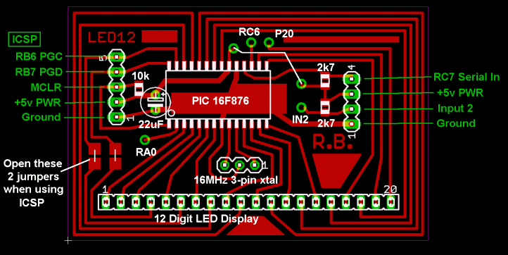

Hi I just finished this project, driving a 12-digit LED 7-segment "calculator" style display using no parts, no ressitors, no other chips, just a PIC chip.
Since there's been heaps of posts lately about driving 7-segment number displays I thought it was worth mentioning here.

The max allowed output current from each PIC output is only 25mA.
What limits the current on your circuit?
Check out the website audioguru, it's multiplexed.
[FONT=Arial,Helvetica,Verdana,Geneva,sans-serif][SIZE=-1]Now for the safety. I drove the segments with a duty cycle of 1:24 so that only 4 segments can ever be lit at one time. So it multiplexes the top 4 segments, x 12 digits, then the bottom 4 segments for 12 digits again. Multiplexing is at 256uS (using TMR0 interrupt) which runs each LED at 162Hz. There is no deadtime, so peak (instantaneous) current is 55 segments / 24 multiplex which is the equivalent of 2.29 segments on all the time, so that is 51mA / 2.29 = 22.3mA per lit segment peak instantaneous current.
22mA per PIC pin is well within safe specs, and the most segments that can be lit at once is 4, so the max sourced by PORTB in total is 4x 22mA or 88mA. PORTB is specced at 200mA so that is fine. The max current sunk into PORTA or PORTC pin is also 88mA, which is technically above spec but can never be more than 1:12 duty cycle and must always have the long cool down cycle (11 periods) after any time it is used. Since the pin pull-down drivers are NFETs this should be comparable to any pulsed NFET with a low duty cycle, which is the average of 88mA / 12 or 7.3mA sunk per PIC pin is the worst case.

TCM, you could make a 12 digit voltmeter with a PIC, but since the PIC has only 1024 resolution points it wont be much good after the first few digits. But the PIC has 5 ADC inputs, just with 2 of them you could make this;
12.75v 1.04A
which fits fine in 12 digits even including the 'v' and 'A' chars. You can also program it to do overvoltage indicators or errors etc, something you can't implement on a typical digital panel meter.
