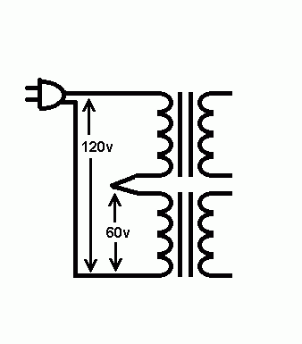

I have another Idea Hook two Transformers in series and tap off of the middle terminal.

I suggest you tell us EXACTLY what you are trying to do, if you're talking extremely low current levels transformers 'might not' be required, but may still be prefered for safety.
I see variacs for sale now and then - might be a solution although overkill if you only need a little current. I paid $10 for my variac - I don't think I could buy a 220/110 transformer for that price. I don't think these provide the isolation you need.
Isolation leads to next suggestion - obtain isolation transfomer (1:1) then use appropriately sized resistors.
Older industrial systems use transformer to step higher voltages down - like the 220/110. While overkill you might find one in a surplus store - or get an electrician to give you one.
As others have said, keep safety in mind here and if you aren't skilled in working with mains voltages get help or stay away.

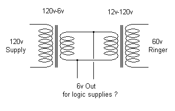

Another Ringer Supply
I ageree with Nigel - ISOLATE !
How about using two little transformers as below - a few quid each, both of the sort used in transistor radios.
The first one is 120v to 6v - this can supply any logic you may require?
the second is used backwards as a step-up, a 12v to 120v transformer gives 60v out.
There are myriad variations on this.
ps. the step-up transformer needs to be a lower current rating than the step-down in order to ensure the step-down transformer isn't overloaded.
Maybe I didn't understand your circuit ... but this is what I tried.
I took a 120VAC->6VDC transformer, plugged it in, fed the 6VDC into the output of a 120VAC->12VDC transformer, expecting approx 60VAC to come off of the plug connection.
I did that, but I measured like 0.1VAC ... did I do something wrong or totally misinterperet the circuit?
Transformers working only with AC voltage.... The wallwart supply produce DC. Open it, and connect two wires directly to transformer secondary.
