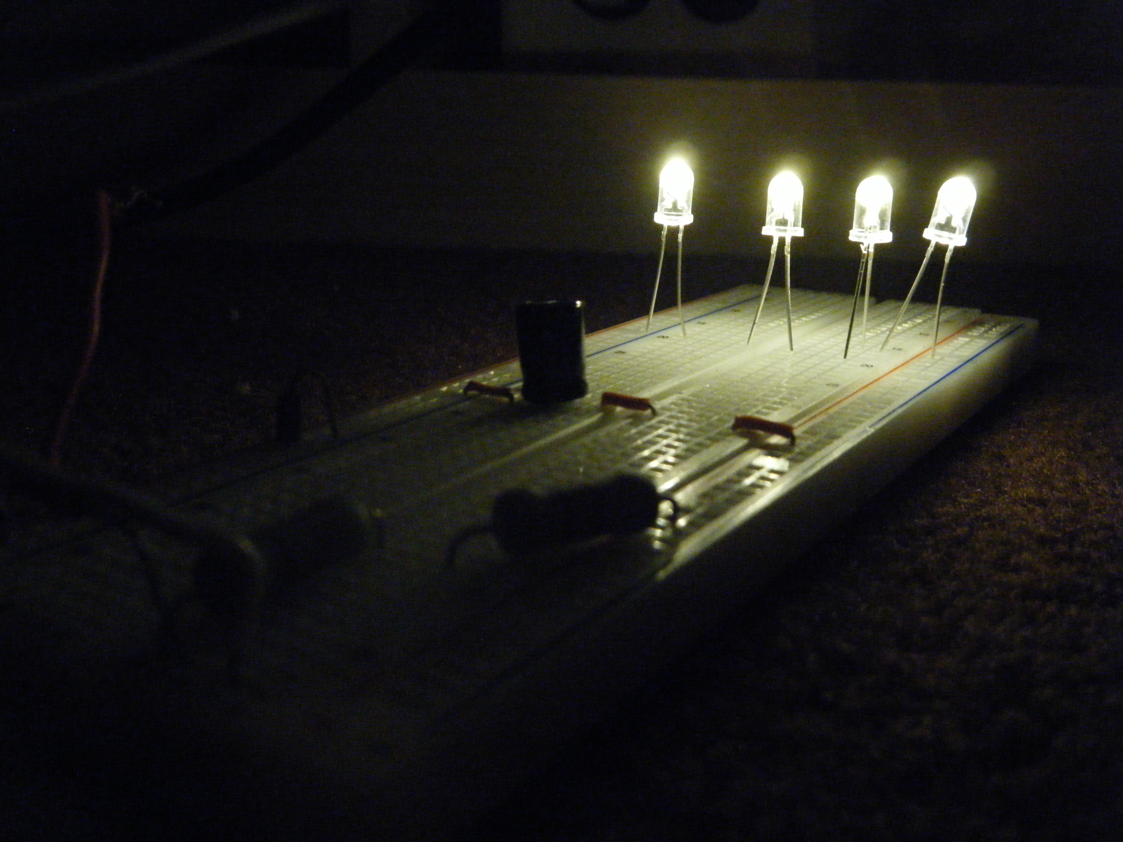

I made a circuit for a 120volt AC night light. Hope you like:)
https://www.electro-tech-online.com/content/345-120volt-led-night-light.html
Parts:
1x 1N4007
4x white leds
1x 100uf-220uf 25volt capacitor
1x 9.1K 5 watt resistor
1x 1Meg 1/2 watt resistor
When I took the picture of the circuit working, I only had two 4.7K 5watt resistors on hand.
I had also written on the circuit that C1 is optional because some people don't see flickering.
120volts IS Dangerous!!! Be CAREFUL!!!

The 120volts is only rectified on one cycle so the 9.1K resistor dissipates around 3.5 watts instead of nearly 10 watts!
The 1Meg resistor eliminates [most] voltage spikes.
You can use a 100 to 220uF cap for C1.
When you first test it, you should run it on an isolation transformer.
You might be able to double the resistor value though, I'm not sure, I never play with 220volts, only 120volts.

The leds don't always have to run at 20 mA's. Often at 10 or 15 mA they are just as bright and saves in heating of the power resistor.
I have a couple of clips of 120 and 240 Volts led lamps on my YouTube channel which show how I make them.
The more led's in series the less voltage drop across the resistor (or Cap)

Yes rodalco. I have played with this circuit a lot.
When you run leds for a while at thier max current, thier mcd rating drops over time. Leds will still be bright when ran for a long time at a lower current.

Circuit V2.0.
It uses a capacitor to replace the 5watt 9.1K resistor in the original circuit.
The capacitor takes up more space than the resistor but the capacitor has an advantage-it does not dissipate any heat.
This circuit still is designed for 120v and I've tested it too.
Turn on time is about 1/6th of a second.
If you leave out R2, your sensitive leds will be led to thier doom after a few on/off cycles.

Your LED current is very low. Series dropping cap should be about 0.5 uF for 20 mA's on LED's
Leds don't need 20 mA, when you run them on such a high current, they dim over time, and they run hot decreasing their lifetime even more.
