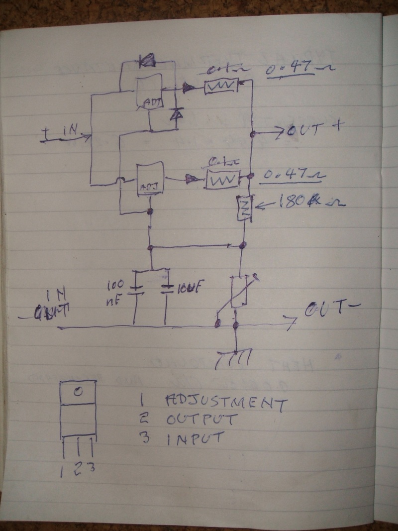

I am now at a point where I can either use the TIP35C or the 2N3055 transistors. I have managed to follow the printed circuit board of the old line amp and towards the TIP35C transistors it almost looks like a power supply. I could use that part of the board.
I have no experience with power supplies at all, I have managed to get 2 LM338's in parallel to work after several attempts. Any advice about which power transistors to use would be very much appreciated.
