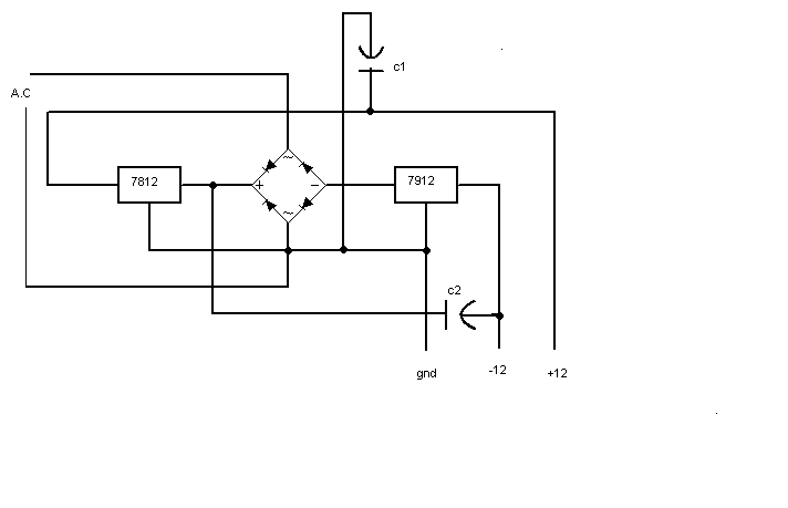

+12v/ -12v
sigma
I'm building an audio amp.
and needed to know if I could use this power supply.
tnx.
Use a centre-tap transformer. The centre-tap will form Ground terminal. Connect other two terminals to the bridge. The + outptu of bridge goes to 7812 and - to 7912.

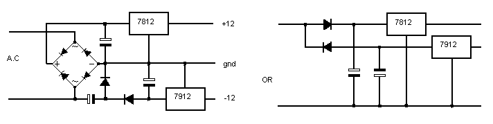

Your circuit can't work. Here is two version of dual supply,or use a center-tapped trafo as Kinjal wrote.
