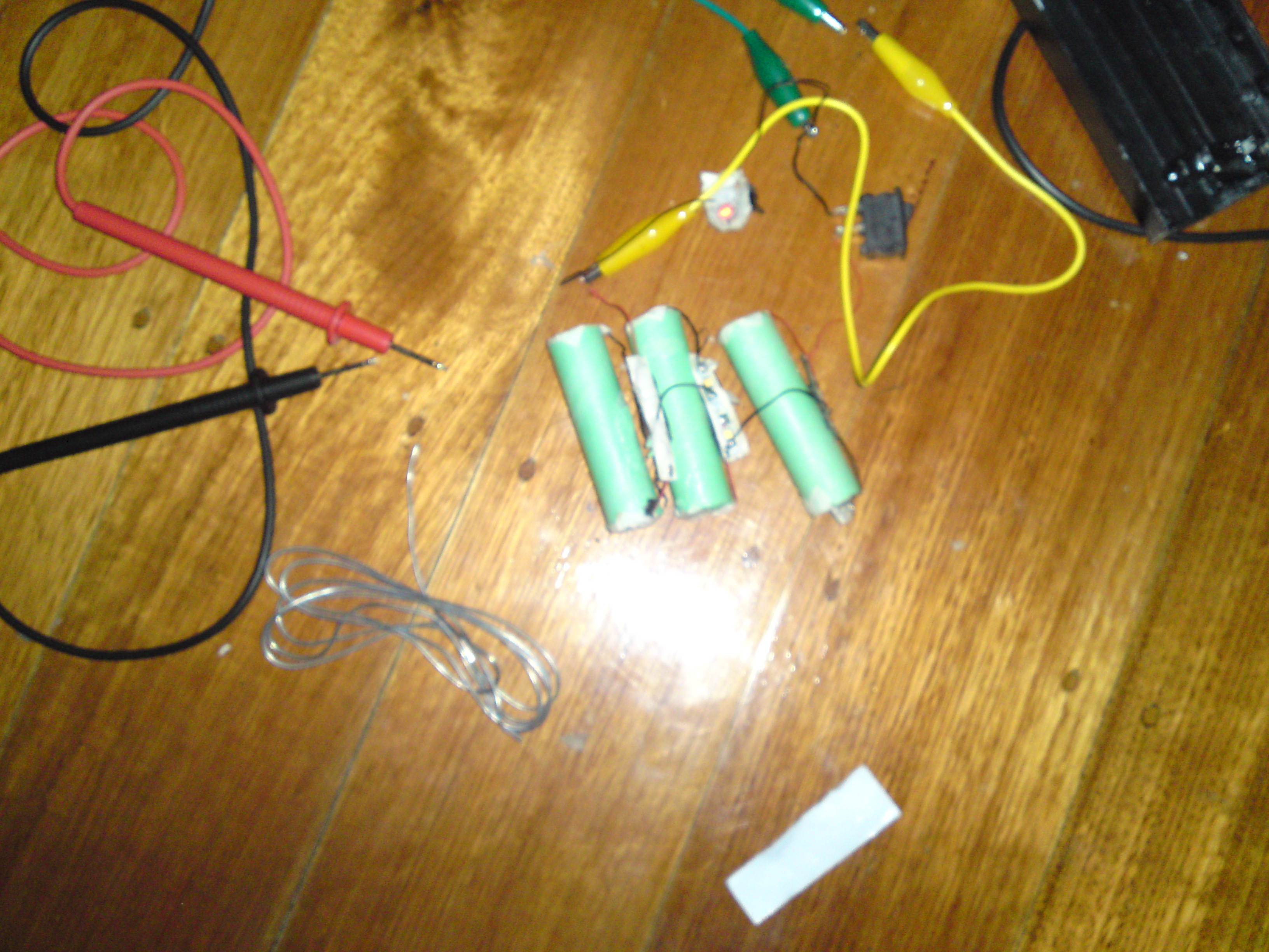

I have purchase a 12v DC Li-ion battery pack awhile ago. **broken link removed**.
Its current limited, as soon as short occurs it only puts out 2.98v and to reset it, it must be conected to recharger for couple seconds.
The problem im having is its not holding its charge, ive conected a Multimeter across to measure V after recharge and i get around 12V then gradually drops 0.01v every couple seconds. And all that its really running is an LED to show that the unit is on.

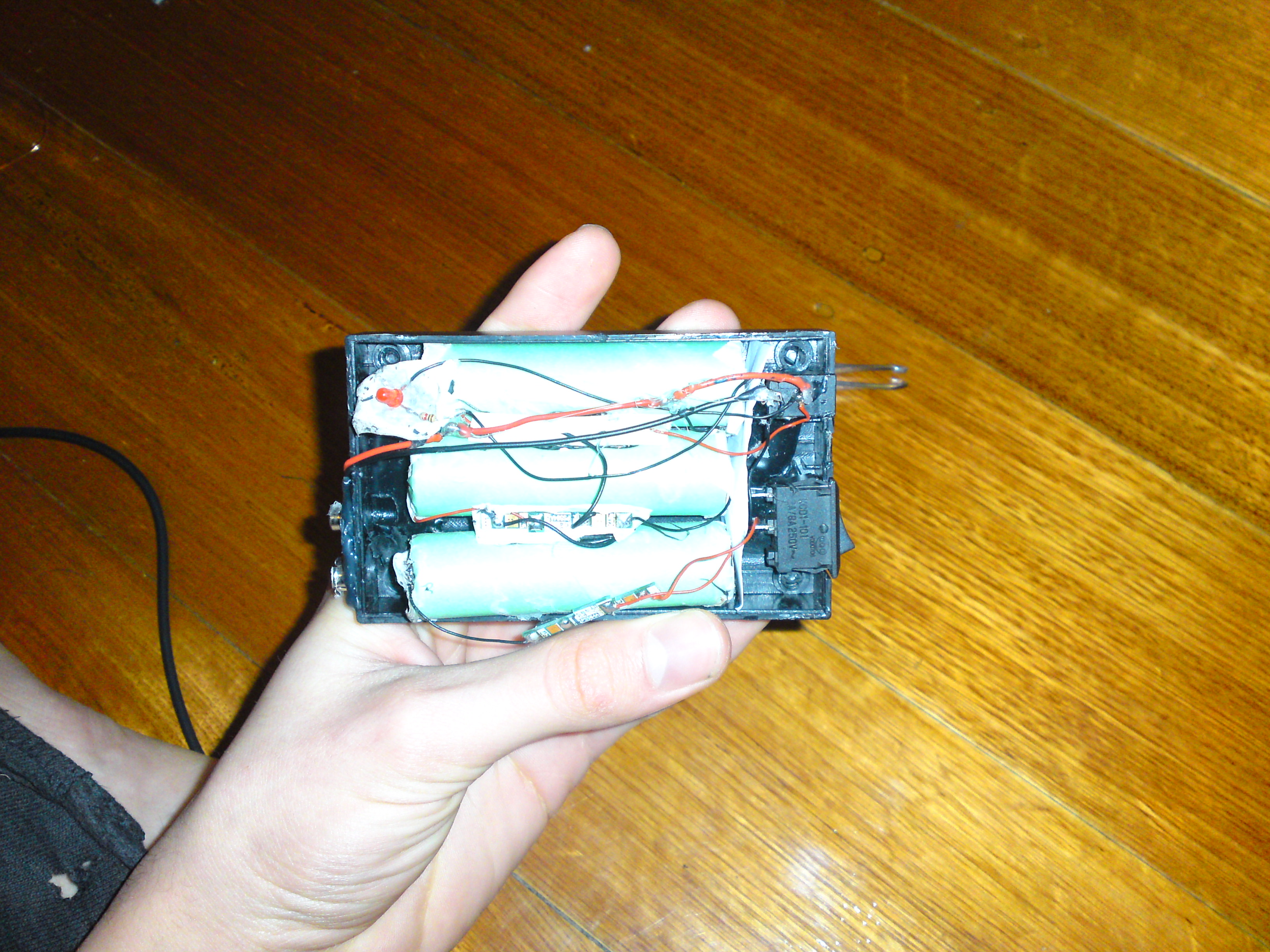

I ripped it open an found that the battery on the right has voltage drops every couple seconds and drains down to 2 or so volts. The other two dont change from 3.98v(left) and 4.16v(middle) during use, or after recharge.

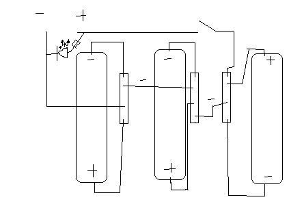

Each battery conects to an little IC then to next battery and so on.
below is rough idea of electrical layout. aswell as some photos.
if anyone could explain whats happening here and how i could fix it woulld be most appreciated.

What is the voltage across each individual cell.
what are you using to charge it, and at what voltage.
left 3.98v middle 4.16v right 3.9-2.3(only one that varies).
Charging is done with supplied wall charger which outputs 12.6v @200mA

Your battery has one cell bad or the protection circuit is bad.
Either one cell is bad or that cell is simply dischrged deeply and your pack needs to be balanced. Li's in series have to be balanced periodically to compensate for differences in cell capacity since they are charged from a constant voltage source. If you have a good power supply you can set to 4.200V, you can charge each cell individually by connecting directly to it. Then retest the pack and see if all the cells work OK. If not, the cell is hosed.
the charger was supplied with the unit.
So you believe it might be the right cell. OK ill try my benchtop power supply to supply each cell with 4.2v, at what amps should i limit it to? Do you think i might need to disconect the cell from each individual circuit board?

I would limit it to about 0.5A. I don't know if each cell has to be disconnected, I doubt it if you connect the PS directly to each cell.
You got it from Ebay? They are probably factory "seconds". The factory sell off bad batteries for peanuts, the typical fault is one bad cell. Then unscrupulous ebay resellers sell the factory seconds as working batteries. :(
Another point: some of the Li cells (older chemistry) die if let to discharge too far. The original Sony cells did, but they changed the cathode chemistry to fix it. Last I heard, sanyo cells died if allowed to go down too far. There is a non-reversible "plating" that occurs on the cathode which eats up most of the cell capacity. Not sure if that's your cell, but if it won't take a charge, it's hosed.
All of your assumptions seems correct especially Mr RB with concern to factory seconds, i believe this is the case because im pretty sure this has been happening from when i first got them. Ive connected my PSU straight on the right cell and set it on 4.2v at 0.5amps for around 3-4hours and it seems to be holding its charge while running the LED now, when i get some time ill see how it goes with a more current requiring job.
