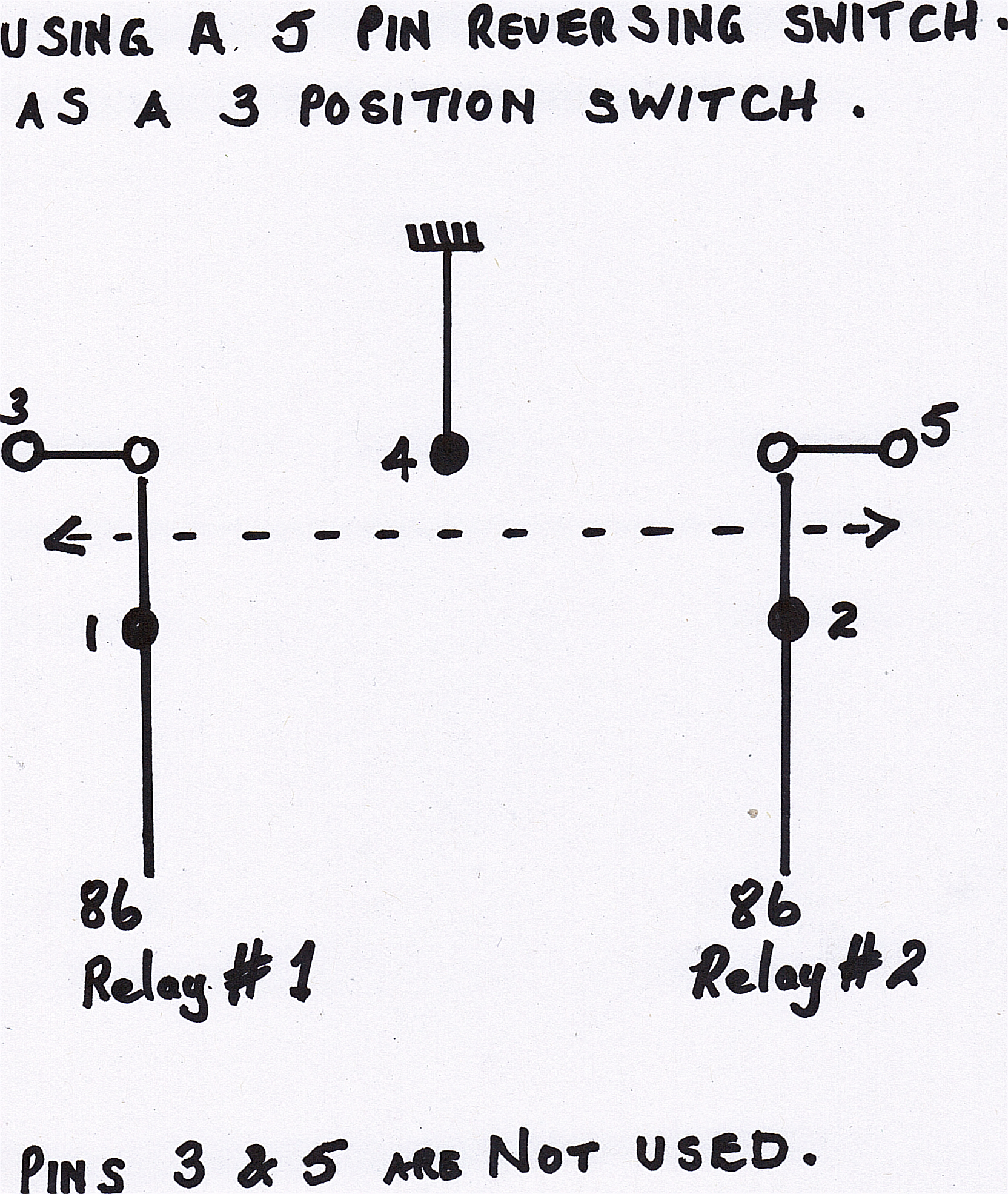

to be more precise, in my car I decided to install a spal aftermarket power window set. if I'd go for the usual switches everything would be ok but I found another pair of switches (of "delicate" nature) that won't allow much current to go through (but they are sooo cute). so, relays are the only way, if I am not wrong. I'd go for the DPDT type (2 per door I guess) but I don't seem to find any that could rate at 20A, and of course not cost as much as the window set itself.
so I wonder whether there is a way to operate the window motor (up/down) through some more common relays as I will have the signal (up/down) coming from the (cute/delicate) switch
I have been through other similar post replies but I don't think they cover me. so any idea would be most appreciated.
thanks a lot for getting into the trouble of reading my post in the first place
