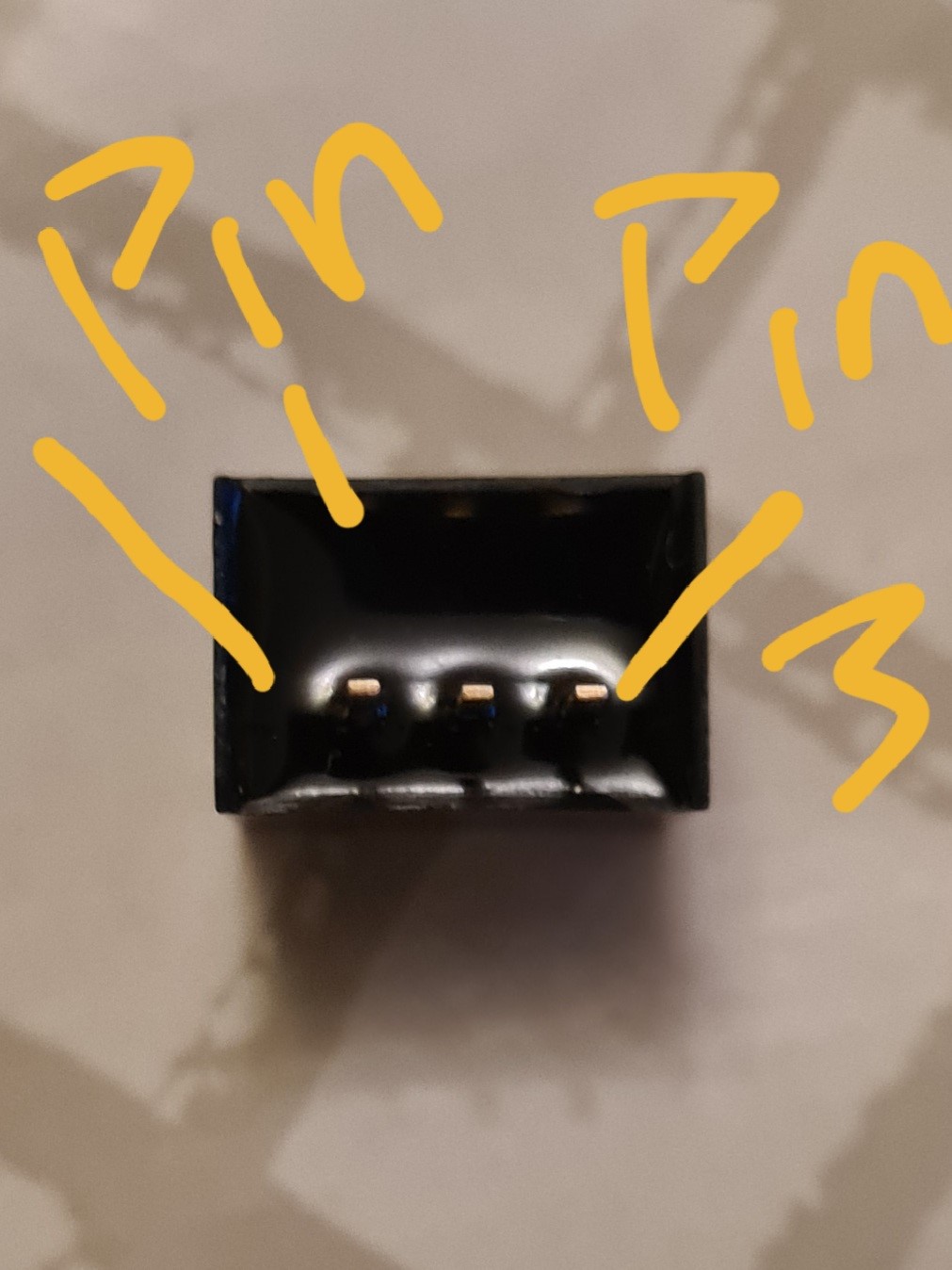

ive been trying to design a circuit to protect my led rear light units for use in a car which car get a variable input voltage of 11.8 to 14.6 volts so i decided to go for a voltage reduction to 5volts.

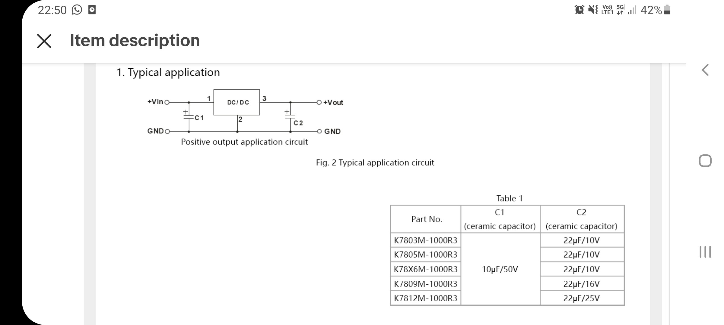

im using a rs pro k7805m-1000r3 dc to dc converter. as per the circuit for the item with capacitors (see picture attached) i suffered the capacitor on the voltage out blow up when the volts got to 10.2volts on the input side. what have i done wrong? ive attached how i did the pcb wire up.
cheers Michael

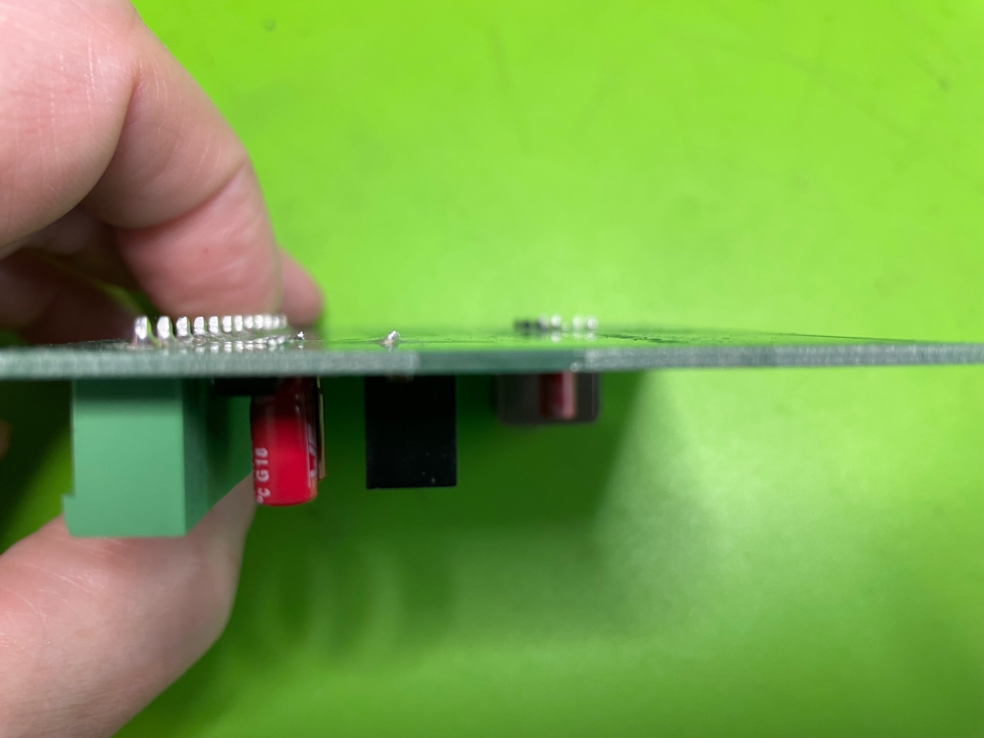

What type of capacitors are they? If they are polarised, is the polarity correct?
Other than that, it could just be the wire lengths that are upsetting things; even a normal 7805 type regulator can oscillate with more than a couple of inches between the device and the capacitors.

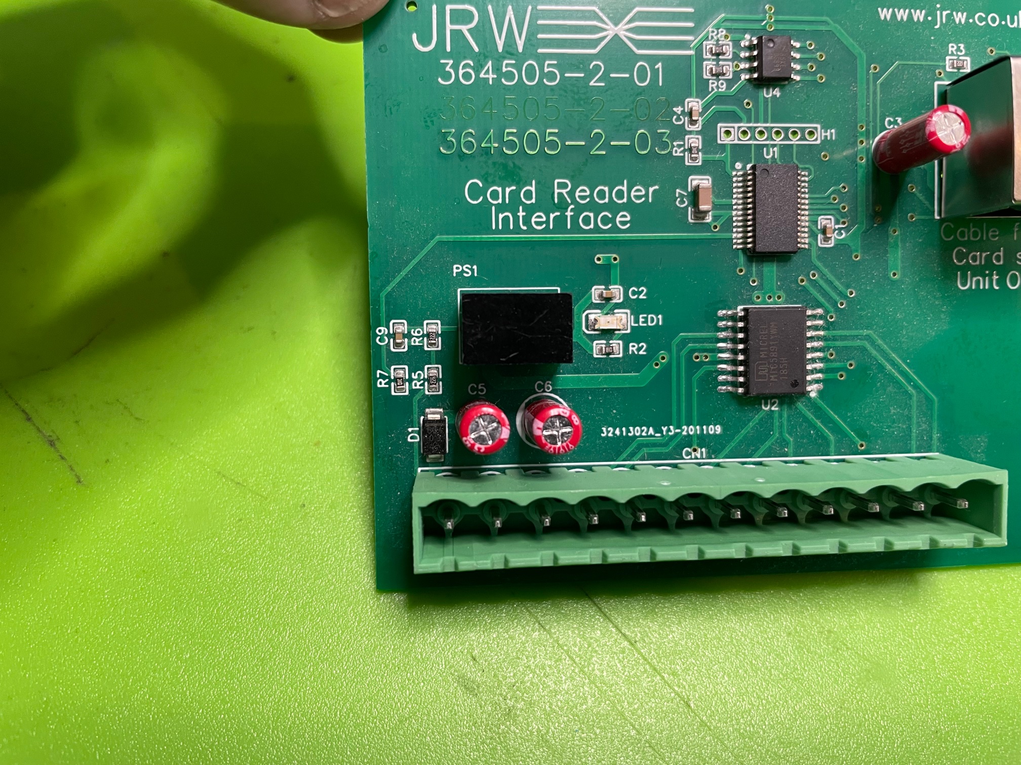

Looking again, I believe you have the regulator reversed? This is one of those RS switching regs in one of our products; the pins are offset towards the green connector and the input is at the left or near end in the two photos respectively - what you show as Pin 3 in the photo:
I agree with rjenkinsgb that you seem to have pins 1 and 3 swapped.

cheers guys, turned out it was the capacitor that was the wrong way. yeah ive got a resistor inline for the led. the problem is the led lamps that ive built for my car havent got any protection as the orignal plan was to have the controlled through a arduino.
