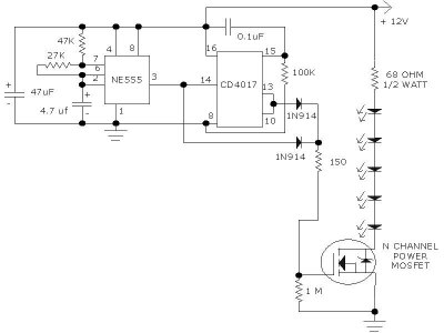

The title is a bit misleading, allow me to explain. I drive a very small and lightweight car, and feel very vulnerable in it, especially to rear end collisions. I have a number of very bright LEDs with a forward voltage of 2 volts, and a design current rating of 50 ma. I would like a circuit which would power an array of these LEDs, perhaps up to 80, but at least 50, and I would like it to behave in this manner:
Closing a switch (brake switch) supplies positive positive voltage which may vary between 11 and 15 VDC (natural variation in car's electrical system) to the circuit. At the presence of this voltage, the the LED array would flash 3 or 4 times befor lighting steady. They would remain steady on until the switch is opened again. Whether the LED flashes are limited by a counter or a timer and flash rate is irrelevant. Also, it is acceptable for the circuit to drive a relay which turns on another circuit containing the LED and their current limiting devices (as opposed to this circuit limiting the LED array current directly).

Here is a circuit that uses 2 IC's and a few other components. The LED's in series have the current limited by the 68 ohm 1/2 watt resistor. The other strings of LED's can be put in parallel. Once power is applied the LED's will flash 4 times and then stay on steady.
I forgot to include a 1M resistor from the gate of the Mosfet to ground.
A new schematic is posted

So, it looks as though this can be set up to operate within the law. The micro controller sounds fine, but as I said, I am no designer, and actual circuit is what I need, I am too ignorant to make use of generalitys. The circuit above looks simple enough, I presume flash rate can be altered by selecting a resistor value near the 555 timer or something. Thanks for the responses guys. I'll try this circuit out within a week or two, but I am also open to other suggestions if anyone has them.
I have a question about this circuit, did you design that that quickly, or was this an existing circuit out there somewhere that I was unable to find? Either way, I really appreciate it, thank you very much.

The circuit was designed and tested recently. I have been building circuit to flash LED's for quite a while. The resistors connected to pins 6 & 7 plus the 4.7 uF capacitor affect the flash rate of the LED's. The 4017 determines how many flashes occur, so it can be changed also. Glad to
help.
12V LED flasher
The circuit I posted was missing a 1M from the gate of the Mosfet to ground. Sorry for the error look at the post for a new schematic.

I really appreciate what you have done for me here. If you might indulge me one more time (I think), not being the electronic whiz. There is no part number for the mosfet, before tonight I could not have told you what a mosfet was. I gather they are somewhat universal, as long as specifications match intended use. Could you verify that this ( https://www.newark.com/product-details/text/CD121/65870.html ) is what I want or alternatively, steer me in the right direction with a recommended part number and source. Thanks again for the help, you've been great!
Lance
12 Volt LED flasher
The NDP6060 should work. And would reduce the 1M resistor from the
gate to ground to 47K ohms.
