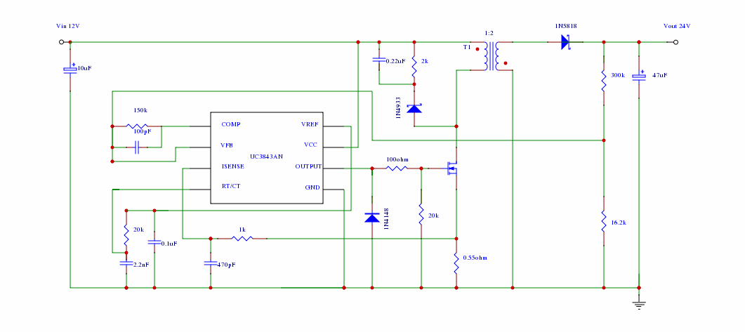

I'm trying to design a flyback DC-DC converter which can provide up to 24V DC from a normal 12V DC lead-acid battery that every car has. It can be used to run radios, small lights, relays, horns and other 24V accessories(multiple output) from a 12V vehicle.
I have done research on flyback topology and design the circuit diagram. I couldn't get the 24V DC from the output, after I assembly all the components. Is my design having problem or I selected the wrong flyback transformer?
Attach are my design and the info of flyback transformer.
https://images.elektroda.net/11_1312757763.gif
https://www.electro-tech-online.com/custompdfs/2011/08/323239.pdf
IC chip is UC3843AN(current mode) and flyback transformer is myrra 74014.
PLS HELP and advice!!! Thank you.

Your turns ratio is wrong. The transformer you are using is designed for mains input. You need your turns ratio to be roughly equal to Vin:Vout. This keeps the duty cycle in a reasonable range and makes sure you dont end up with huge flyback pulses on the primary or too much current on the secondary. I am also not sure what flavour of FET you are using. You need this to have a low ON resistance and a low Qg to get the effiency high. Remove the 100 Ohm gate resistors - this is only there to reduce EMC, but it will kill the efficiency of the converter. You need to tweak the current sense resistor in the source of the FET to put more (or less) power into the circuit to get more (or less) power out. The saturation current of the primary needs to be higher than the current set by this resistor, as does the Ids of the FET.
Please see the following on other points to note on Flyback Converter Design:
http://www.simonbramble.co.uk/dc_dc_converter_design/dc_dc_converter_design.htm

You mean I should change the flyback trasformer or change the design circuit? I can't find the other flyback transformer which is under my requirement in the market anymore.
I am using IRF540N (IRF 540N MOSFET N-CHANNEL).
I am newbie in this area, please give me some guide and advice.Thank you.

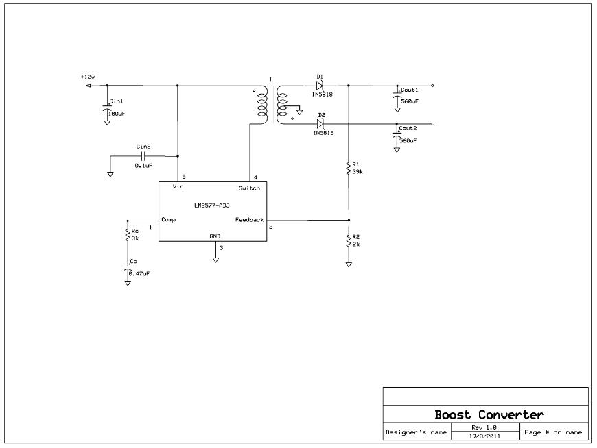

hi all, thank you for all reply and advice.
I was able to generate first output(24VDC) with S1 and 0V,but further add on S2 and 0V,the circuit showed error and can't generate both outputs(24VDC). For the second output, I only connect the zener diode(1N5818) and capacitor. Should I add the feedback loop for second output or add opto-coupler to isolate the output voltage?
Please advice.Thank you.
What are S1 and S2?
Post a schematic.
crutschow,
attached is my schematic diagram.
S1 is pin 9 from transformer 74014, and S2 is pin7.
when I switch off the 12V DC power supply, the voltage from second output will drop very slowly(0.01VDC~0.02VDC), meanwhile the voltage from first output is drop normal..at the same time, the temperature from IC chip is high.
what is the root cause for this problem?how to fix it?
please advice. Thank you.
