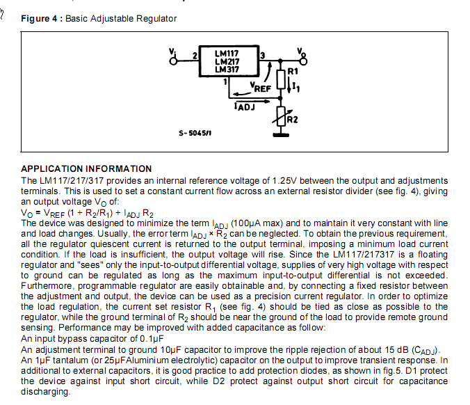

Look at this extract from the data, use the formula to calc the Vout.
Thank You, I was never good at the math, so how does the math work out to get 6.7vdc ?????? don"t understand it .
