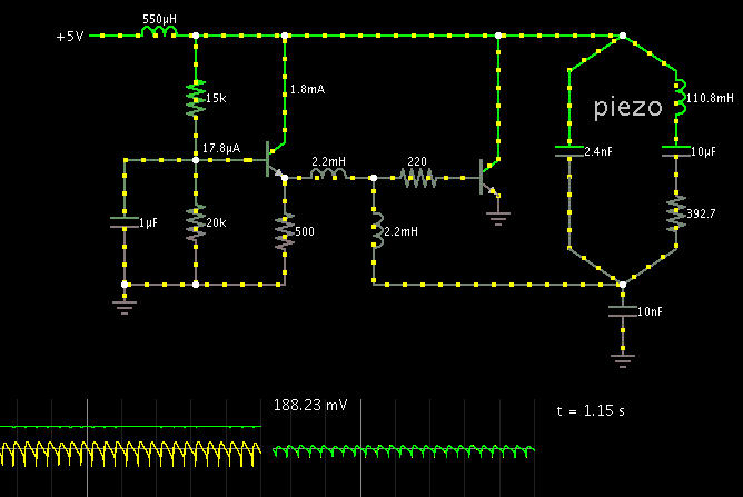

I actually found an alternative circuit to drive the piezo transducer (Nozzle), which seems quite a bit simpler than the other one I uploaded here earlier. It also needs only 5V and 200mA (1W), which is great.
I have also created a simulation of the circuit using Paul Falstad's simulator (falstad.com) after I found an equivalent circuit of the piezo electric ceramic ultrasonic transducer (Q&A). However, the numbers given there were for a 39KHz resonant frequency.
Could someone help me translate these into 135KHz+-5 to match the actual piezo I'll be using? Let me know if you have any comments about the circuit.

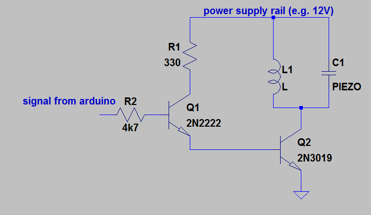

On the one hand, I have a piezoeletric component that needs to be driven by a frequency between 130KHz and 140KHz and I am planning to control this circuit (turn it on/off, change the frequency within this range) using an arduino board. This arduino board will also be connected to other stuff (sensor/actuators).
(3) The third thing is that I was wondering if there are components/subsets I can trim out of this circuit since I will be using an arduino board to control it. Can an arduino uno board generate these frequencies directly (I am assuming not)? Or do I need a subset of these components (I understand that the 5V will be provided by arduino and I won't need the voltage regulator)?
The frequency can be produced directly on the arduino board. I'd suggest using one of the hardware timers, 8Mhz/59 = 135.6KHz. The output is then fed into a couple of cascaded transistors, the second of which drive the inductor and transducer as per your first circuit. e.g. see the attached cct

dougy83, thanks for the circuit.
I have checked with the manufacturer, though, and the second circuit I linked is the latest one. It is simpler (actually similar to yours) and requires only 5V and 200mA supply. So since I am not that versed in electronic circuits specially the ones with active components, it will stick to this new one learning as much as I cant along the way.
I have already ordered the piezo nozzle, now I need to order the electronic components. Here I got stuck in the inductors. Spent some time reading about them and now I understand at a high-level the roles of capacitors and inductors (in addition to resistors) in circuits. The circuit specifies 2x 2.2mH inductors and 1x 0.55mH inductor. I did a search and found two brands using Octopart.com:
