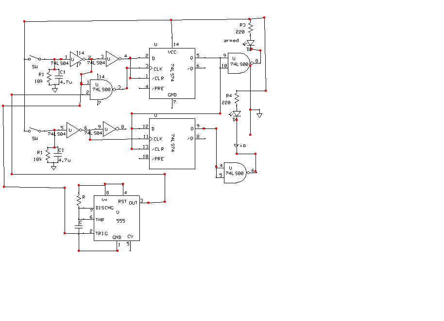

The problem now is that my trigger is not a pulse, it's a constant high signal. How can I generate a single pulse from the rising edge of my trigger?
inserting a 555
here is a basic schematic to integrate a 555 into your circuit
still think a PIC would work better , less parts, better accuracy etc.
needs work but ???

Thanks, but could you clean it up a bit and at put arrows towards where I'm meant to connect things up? Right now I can't make out a lot of it (e.g. the bottom right 7404 doesn't seem to do anything).

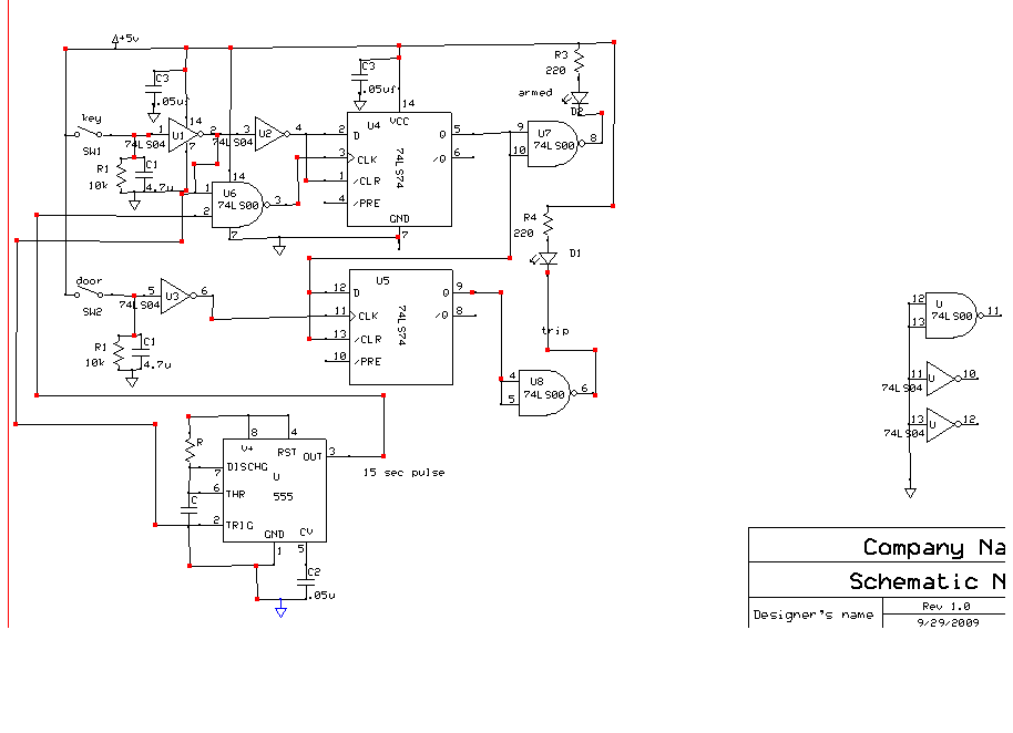

revised schematic
when output of U1 goes low it triggers the 555 for a 15 second pulse
after 15 seconds the output of U2 goes high clocking U4
If sw2 is not closed before 15 seconds then output of U5 pin9
goes low thus
triggering the alarm.
unused TTL inputs must go somewhere, not floating thus they
are grounded.
using the unused portions of the 74ls00 saves having to use transistors.
a 556 timer could be included to indicate if the alarm was triggered
with a blinking LED.the unused portions of the 74ls04 could also be used for the
blinking LED
this circuit needs to be checked and bread boarded before actually assembling.
it is based on your original post but does it really work??
added decoupling caps to all Vcc/ground connections of all IC's
hope this helps but haven't really deciphered entire logic table
