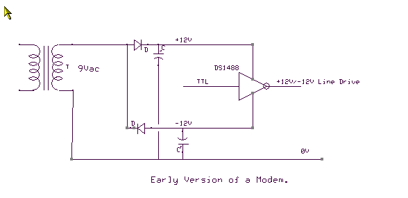

DC yes, but in case you are NOT aware, there a two polarities of DC , POSITIVE and NEGATIVE.
I suggest you Google voltage polarity and see what you can learn.:p
EDIT: I think also Googling Rectification would put you on the right track.
EDIT: to make it easier to follow, a diagram of a Earlier Modem Line Driver stage.

If you are nitpicking then sugest a both polarity from a reference point politicaly CORRECT.

Voltage is not born with polarity WE the designers users assign polarity. Current flow assign polarity not the presence of a voltage which can be +/- depending on current flow. Want to know more?
