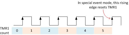

So you have an extra count like this (edit: Compare register is set to 5 in this example - not doing all 99 :)

Check the drawing in my first post.
TMR1 starts with a count of 0.
First rising edge clocks TMR1, counter = 1
Second rising edge clocks TMR1, counter = 2
Third rising edge clocks TMR1, counter = 3
and so on.....
As soon as the value in TMR1 counter matches the CCP register the special event is triggered. So if you had 99 in the CCP registers it would trigger at 99 clocks. If that also reset the TMR1 to zero, the divide ratio would be correct but it doesn't. The TMR1 isn't reset until the next rising edge so you have an extra clock

After an event, the first rising edge resets the counter to zero. Second rising edge counter=1, third rising edge counter=2.. so on. You can call the zero "an extra count" if you like. What ever works best for your brain. I don't like to think that way.. doesn't work for me.
I concede, you're right, that is a better way of expressing it.

I don't mind that you think it differently, but if you really think about the details, the event must be fired the same time the counter changes to compare value. Imagine that a marathon is supposed to start at 2:00 pm.. it must make sense that you fire the start gun exactly when the clock changes from 1:59 to 2:00.
And I hope it is logical to you that the next counter value after the compare value is zero.
The counter cycle must also include the compare match value. It cannot reset to zero before that.. otherwise it would be impossible to do the comparison. Or the comparison would have to be made against zero, and that leads to all kinds of problems, because then you would have hard time distinguishing overflow event from compare event.
