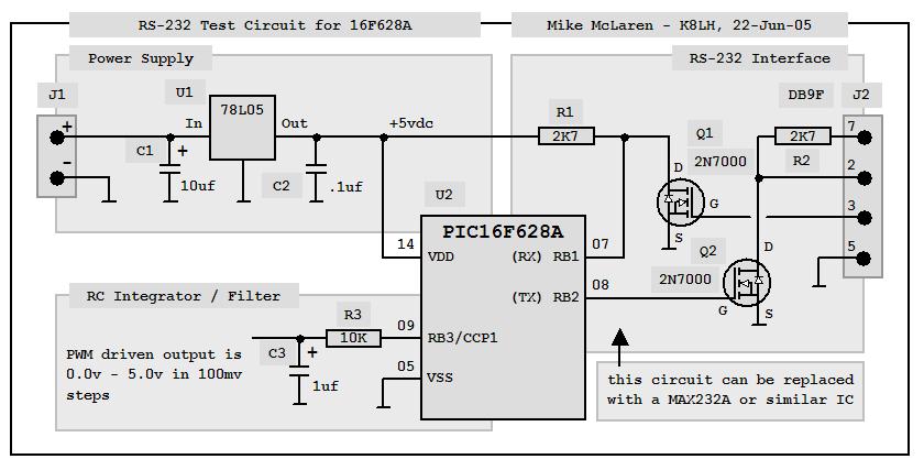

i am trying to output pwm signal from 16f628 pic.
i tried many already made program from the net to do so
and i am using oshonsoft IDE simulator.
i am just seeing changes on TMR2 only
i cant seem to see any pin that has any activity
why is that ?
can anyone just send me a simple hex file (along with asm or basic program please) to output PWM to portA or portB ??

Are you looking at the correct pin? On the '628A the PWM output is on RB3/CCP1 (pin 9)...
Good luck... Regards, Mike

i know i should see any activity on rb3 but there arent any
Ok, I've got a small example assembly program for a '628A with a 20-MHz xtal oscillator...
Which PIC are you running, the '628 or '628A? What oscillator are you running? Are you only simulating this (no actual hardware to test)?
Regards, Mike
Then I wonder if the Simulator simply isn't showing the PWM output on the RB3/CCP1 pin? Or, perhaps you're not setting up a Project correctly with the ASM code examples? Lots of variables there...
Anyway, here's a rude-n-crude circuit and code example... The RC Integrator / Filter allows you to measure a voltage at the R3/C3 junction that corresponds to the PWM setting... Adjust the PWM setting up or down using the '>' and '<' keys in Hyperterminal...
Good luck... Have fun... Kind regards, Mike

well i think you r correct, maybe the simulator just not showing the pwm
output
i have to physically test the circuit i guess
