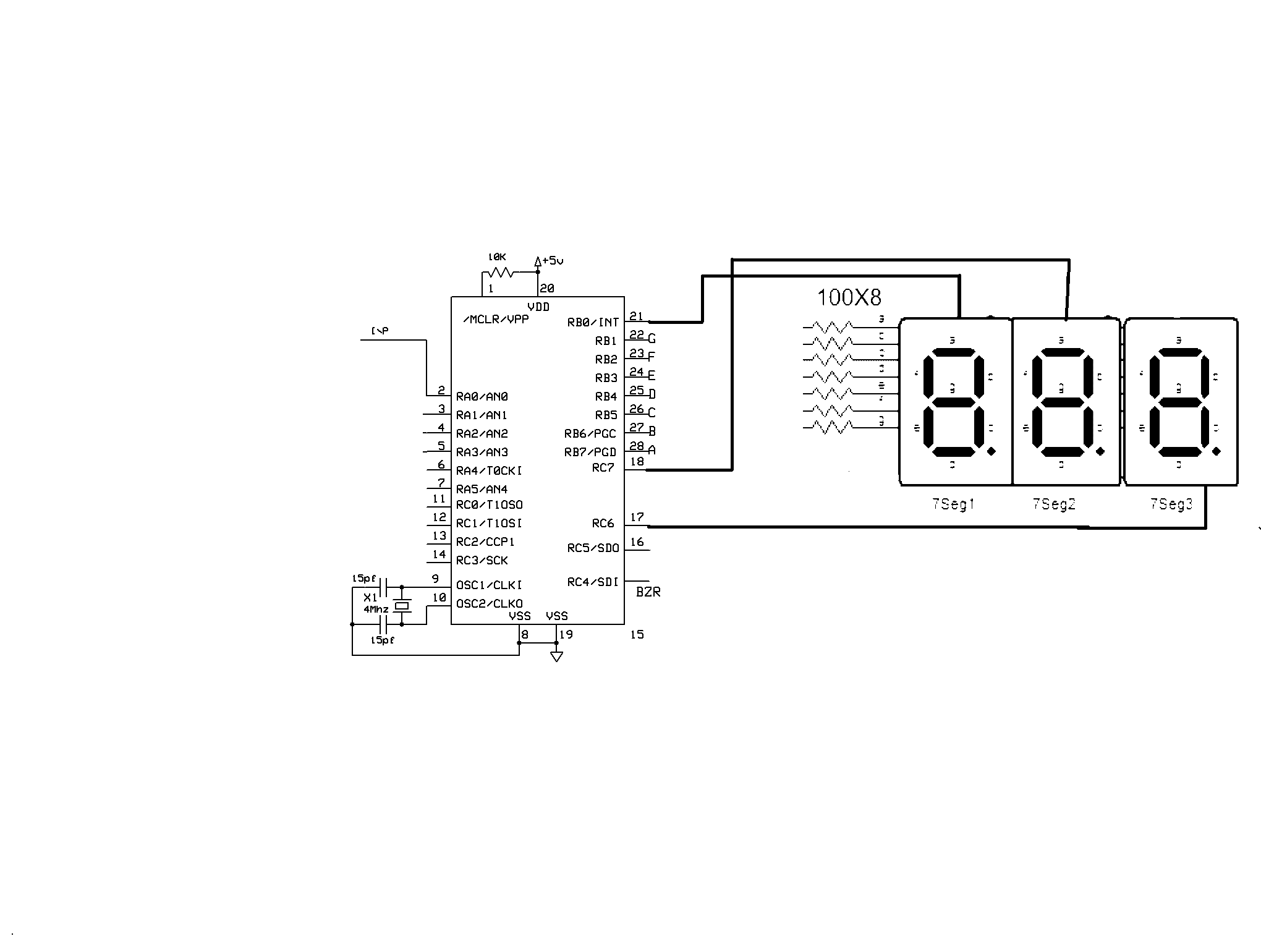

i'm trying volt meter code conversion 16f676 to 16f72 step by step . use CCS C

1st of all trying understand
7seg. aregment
676 as
const char SegCode[11] = {0x40,0x57,0x22,0x06,0x15,0x0C,0x08,0x56,0x00,0x04,0xFF};
// 0 1 2 3 4 5 6 7 8 9
i want 72 as
	Ues 7 Segment Common Anod
	PORT RB7 = A
	PORT RB6 = B
	PORT RB5 = C
	PORT RB4 = D
	PORT RB3 = E
	PORT RB2 = F
	PORT RB1 = G
	PORT RB0 = Display 1
	PORT RC7 = Display 2
	PORT RC6 = Display 3
		0= on , 1 = off

but confuse whats right
for exampled digit
1 = 1 0 0 1 1 1 1 = 4F Is right or
1 = 1 0 0 1 1 1 1 = 79 is right
for exampled digit
Both are not right..... you are dismissing the LSBit... so 1001111x will be 0x9E hex or 158 decimal

now i'm doing right ?
how can manege displays ?
( PORT RB0 = Display 1
PORT RC6 = Display 3 )
The best way is to setup a interrupt to update the displays when required..... Nigel's tutorials have a multiplexed 7 segment tutorial...
See the link in my signature.
not understand . in
tutorial 10... Dual seven segment display ( common anode )
my conversion in shown fig.
What do you mean "how can manege displays ?"
How many seven segment displays have you got?
my mean how can manege displays with ( PORT RB0 = Display 1
PORT RC6 = Display 3 ).
for exampled 1 = 1 0 0 1 1 1 1
so pl give example for digit 1 , 2 & 3 management
You are using MikroC... I use XC8 or C18.... If I give you an example ( there is one in MY tutorial... 10 same as Nigel's ) but It wont work on your compiler.
Do I get from the title that you have pic16f72 ?
i'm using CCS C & PIC 16F72 , not MikroC.
