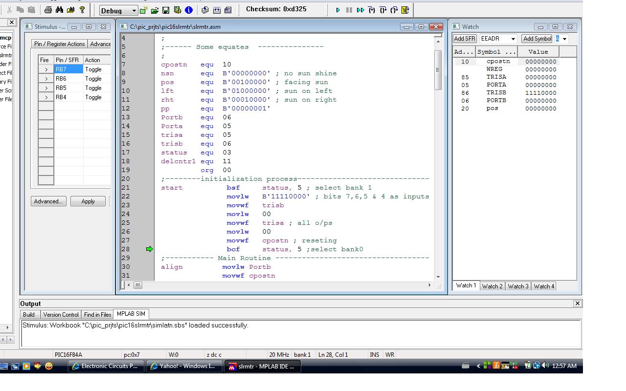

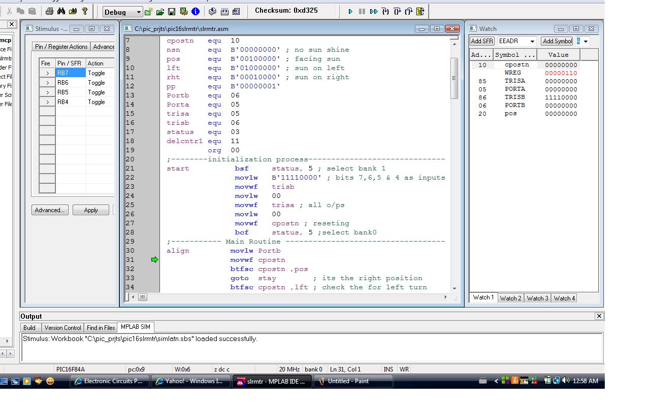

I am trying to capture the current value of portb , but somehow w-reg retains a different value .
please see the attachment.
The debugger is right - your code is wrong.
You have defined Portb as 06 , its seeing that, 'Portb' as a variable, not what I assume you mean as the system register PORTB, so when you load it, movlw Portb, it does just that, moves Portb contents of 06 or 00000110 to the W reg.

It's nothing to do with the equates. He just needs to change movlw portb to movfw portb.

As I said in the fourth post of this thread, you need to use movfw instead of movlw.
align		movlw	PORTB   [COLOR="Red"]<<--- change this[/COLOR]
		movwf	cpostn
		btfsc	cpostn ,pos
		goto	stay		; its the right position
		btfsc	cpostn,lft	; check the for left turn
		goto	mvlft		; sub-routine to move left
		btfsc	cpostn ,rht
		goto	mvrht
		btfsc	cpostn ,nsn
		goto	park
		goto	align
You also need to change it in a few other places.
but left me confiused , why have "movlw" woked else where .
and not here ????
Read what the commands do - MOVLW is MOVe Literal to W - this moves the fixed number following it into the W register. In the case of PORTB, as that has the value 6, it will move 6 to W, and nothing but 6.
MOVFW means MOVe File to W - this moves the contents of the file register specified to W, which will vary depening on it's contents.
