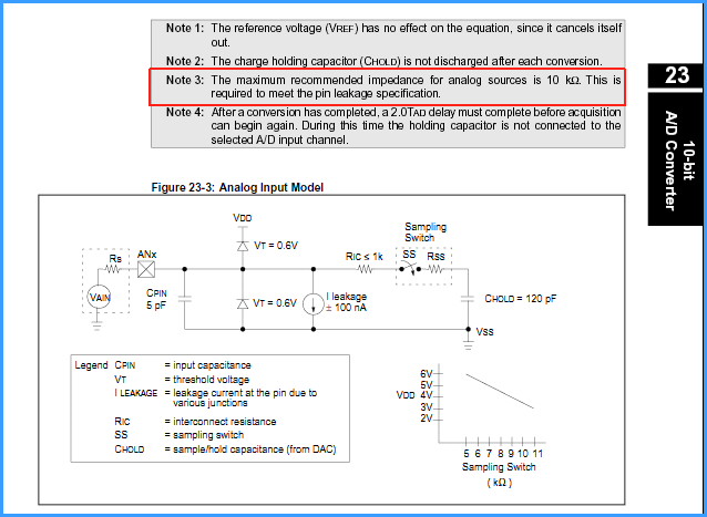

The requirement of the opamp buffer circuit is due to leakage current of the PIC pin. A buffer may not be needed if you use other chip to do the conversion where a simple voltage divider will suffice. Different A/D converter chips has different input requirement and their datasheet usually have example circuit for such purposes.

No it's not! - it's due to the current required to charge the internal sample and hold capacitor - this forms a time constant with the external source resistance, and you have to allow it sufficient time to charge the capacitor fully. With a high source resistance this takes far longer, so you need to take readings much less often.
Even if you take one reading per day and use the remaining time charging this capacitor, the source resistance must still be less than 10K if the full accuracy of the A/D is required.

Have you perhaps tried this?, and if so how did you evaluate resolution to 0.1%?.
The datasheet (for a 16F877) RECOMMENDS the source impedance is no more than 10K, it doesn't suggest accuracy may be any less if it's not, and the possible leakage currents are exceedingly small, and shouldn't affect reading accuracy until you reach much greater source impedances.
Nigel Goodwin said:
... it doesn't suggest accuracy may be any less if it's not, and the possible leakage currents are exceedingly small, and shouldn't affect reading accuracy until you reach much greater source impedances.
Actually, the datasheet(16F Reference Manual) did mention about the effect of this leakage resistance.

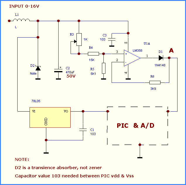

This is the voltage divider and opamp circuit for your project.
In the following circuit:
With 16V input at L1, adjusts R3 VR 1K to give exactly 4.00V at point A.

I can see a number of problems with that (somewhat over complicated) circuit.
For a start, what is the function of the diode on the output of the opamp?, or the feedback resistor?.
The opamp won't be able to reach down to zero volts, although for this application it hardly matters?.
You should have a capacitor on the input of the 78L05 as well as the output, both of them as close as possible to the regulator.
No current limiting resistor between the opamp and PIC, in case something causes the output of the opamp to go high (like too high an input voltage).
Why an opamp at all? - a simple potential divider is all that's required, as it's from a car battery the current doesn't really matter, so simply divide the potential divider values by ten, and feed that directly into the PIC pin.
This keeps it well below the maximum recommended source impedance, and prevents the opamp points I noted above.
I would also suggest using an external precision reference for the PIC's A2D, rather than the not so stable output of the 78L05 - and the potential divider values should be recalculated accordingly.
As far as that goes I would advise (most strongly!), that you DON'T divide exactly by four (or eight, if using a 2.5V reference). Doing so makes the scaling for display rather crude and messy - if you scale it so you get maximum output (1023 decimal) for an input of 20.46 volts, then you can simply multiply the result by two, insert the decimal point, and you have a nice simple accurate reading.

Agree. A simple potential divider is good enough for a car battery voltge measurement. I guess I prepared that circuit that works for most cases in case the OP use it for other purposes.
For car battery voltage measurement, the 78L05 is good enough in my opinion.

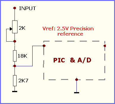

Good idea. Here is the calculation.
Assuming he is using a 2.5V reference, then 20.46V input should produces 2.5V at the voltage divider to give 1023 counts.
Choosing 2K7 as the resistor to ground, the current is 2.5V/2K7. So the voltage drop on the top resistor is (20.46-2.5)=17.96V and the resistance equals 17.96/2.5*2.7 = 19.39K. Therefore we can use a resistor of 18K in series with a 2K VR.

The two posts of eblc1388 show it pretty well, remove the opamp and associated components from the first poest, and add the resistor network from the second.
For an external reference voltage, check my analogue tutorial hardware.
