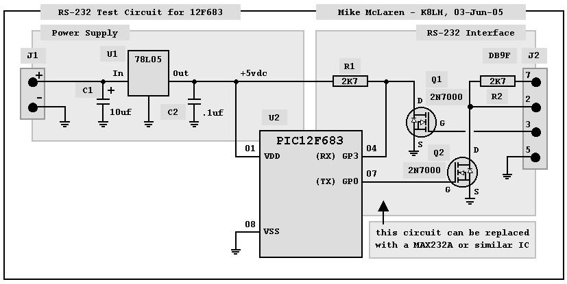

16F87 internal osc runs RS232 are there any 8 pin PICs with an accurate enough internal oscillator to bit bash RS232 communications?
Yes, any of them will do so - the 12C508 series and others have a calibration byte which makes them more than accurate enough at 9600 baud. But even the 16F628 (which doesn't have a calibration byte) runs 9600 quite happily using the internal oscillator.
Bit banged or not makes no difference anyway, the UART runs from the same oscillator!.
The little 8-pin 12F683 sports a 1% tolerance 8-MHz INTOSC and you can find 9600 baud full-duplex and half-duplex demo programs at this Forum Microchip thread;
http://forum.microchip.com/tm.aspx?m=126290
Regards, Mike
Mike,
A quick question about your MAX232 replacement circuit.
As you are using the RTS line as the voltage source for transmission, will this arrangement work with a 3V supply. Edit, have you tried it?
Cool schematic, I've never seen 2N7000s used as the buffer. I usually use a DS275. Question, why bother to invert a bit bashed port? I would normally just use 22K resistors.
PS Mike, I read your code for an 8 MHz clock, I wonder what the maximum baud rate with a 32.768 kHz crystal would be?
Pommie said:
Mike,
Yes Mike, RTS is is used to pull-up the open-drain... Yes, this circuit works well with 3-volt PICs... Here's a "working" 3-volt circuit... <added> Oops, sorry, it's a 3.3-volt circuit (grin)...
Regards, Mike
