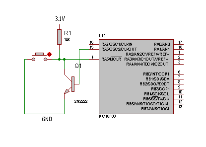

I am working on a project which is going through lots of revisions and upgrades as i work on protocols etc. from my pc.
Now i am having a problem with getting up every 10 to 15 mins while deloping to reset the pic to allow the bootloader to work.
I was wondering if it would be possible to use a transistor to reset the pic.
My idea is to have a NPN transistor (i have a 2N2222 to hand) and put the base to a pin on the pic, the emmitter to 0V and the collector to MCLR and then put the base high.
Thing is i am using a switch too... See the img, i am not good with proteus, but eagle and vutrax have not been installed yet...
Also i have a pic if my setup if u want to see:
regards.
Martyn

The circuit is perfect and it should work perfectly....and u r using 3.1v for vcc but i usualy use standard 5v vcc ..and i also checked the circuit and it works perfectly...pic will reset when base of the transistor is high (2N2222 is high speed switching transistor) and the transistor u used is best for this project.
if u connect an 22k ohms resistor between base emitter...or put an ceramic capacito about 103pf then there wont be any false switching.

You do need a resistor between the transistor's base and the pic's output pin, 4K7 or something, to limit base current,...
or, even better, you don't need the transistor at all. Just connect the output pin straight to MCLR and make it a LOW output to reset (keep the pullup resistor, off course)
i forgot to tell u that u have to put an resistor in between base and PIC pin...to limit the current..
i dont think its a better idea to connect the output directly to MRCL.cause when u press the switch the voltage will flow in to the output pin of the PIC and some times somthing could happens..so transistor or an optoisolater will be better..try these

I don't see how anything could go wrong, the pin connected to MCLR should be configured as an input!. It's only when you want to trigger a reset you make it a low output, in wich case still nothing can go wrong, because your switch is connected to the same ground.
if you make it a High output then something can go wrong, but you just should make sure you don't do this. Ppl use open-collector busses with pics all the time (I²C for example) and that has the same requirement.
