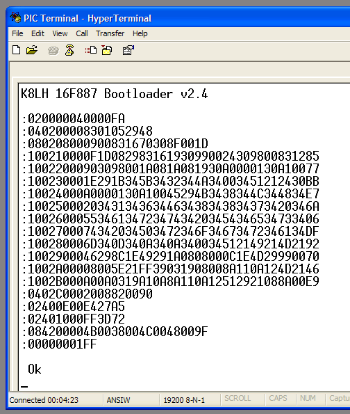

Just got around to testing and debugging a 16F886/887 serial bootloader yesterday that I had written several months ago.
Like my other 16F' bootloaders it resides in the first 256 words of program memory space, uses a "trigger" pin to enter the bootloader during power up or reset, and uses Hyperterminal as the PC "front end".
Transfer standard hex files (which may include holes in program memory space) using the Hyperterminal <Transfer> menu and <Send Text File...> menu item.

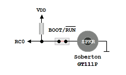

I know many people don't like dedicating a pin for the boot loader "trigger" but up 'til now I've always been able to use an existing allocated pin. For example, on many of my projects I include a miniature piezo speaker which I use for switch press beep or other annunciator type functions. If I install a jumper and a pull-up on the speaker pin as shown in the drawing below, the boot loader can detect a high on this "trigger" pin when the jumper is removed or read a low on the pin when the jumper is installed. You can also use an existing switch on the project as the "trigger". Normally you don't press a switch while powering up or resetting a project so pressing the switch during power up or during reset makes a perfect boot loader "trigger".
Regards, Mike

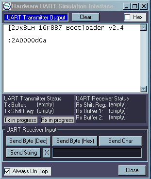

Converted your loader to 16F877A, [have no 16F887 on hand]
Runs OK in the Oshonsoft Sim.
Always find your programs of interest.

Hi Eric,
I don't mind. Please let me know if it works?
I took a quick look at my old 16F877A version 1 boot loader code from 2004 and the algorithm looks similar but I would have to take a closer look to make sure there are no banking differences. The '877A requires you to setup the TRISC bits for the UART pins (the '877 does this for us) so that would have to be added to the code.
I have version 2 boot loaders for; 16F87/88, 16F886/887, 18F2420/4420, 18F2431/4431, and 18F2620/4620. I just upgrade old version 1 boot loaders to version 2 as needed.
Your simulation looks much like "the real thing" (below).
Have fun. Mike
loader-2-4-screen-shot-png.21643

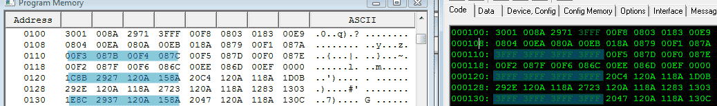

Mike,
I finally got your boot loader working but when i read the contents of the PIC after you bootloader said "OK", it looks like there is a pattern of memory that is not written to in the pic. Have you had a problem with this before?
RE: 887 bootloader
I have attached the file. When I compile a program using MPASM there is no problem. Though I am using Hi -Tech PICC compiler and maybe the hex file is in a slightly different format.
View attachment 887_test.hex.txt
The left side of the pic shows the program memory from MPLAB, and the right side shows the memory read from the pic after using the bootloader. You can see on the right the highlighted blocks havent been written to. its looks like the loader write the first 16 blocks of data, [skips 4, writes 12, skips 4, writes 12]..etc this pattern repeats till the end.
I'm sorry, my bootloader is not compatible with that PICC hex file output.
Until now I've not seen a compiler that generates hex records with data that crosses a 16 word boundary.
Mike

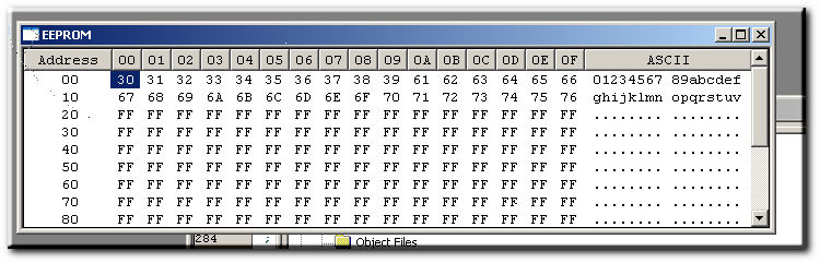

Hello Mike,
I have been unable to get your code to work properly on either an 16F886 or 16F887 using an mpasm generated hex file. The code portion works properly however the EEPROM data does not register properly - I get the first row with 8 bytes and the additonal 8 bytes rewrite over the first one. If I try with a longer string, the second row gets written, but never pass the 8th byte...
When I build directly with the MPLAB, the date is correctly programmed.
I have studied your code very carefully and ran it in debug but I can't figure out what is happening on the second row of EEPROM data...
Can someone help?
Thank you,
Robert

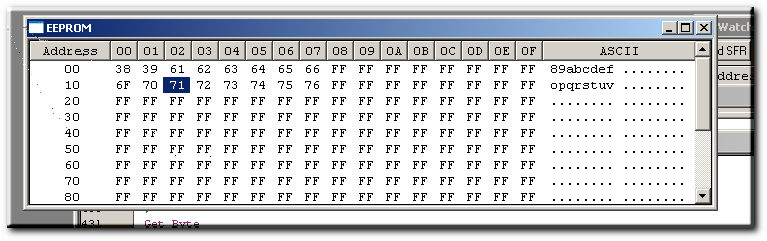

Wow! that was quick!
Thanks for taking the time to test it out. Here is the hex file and a picture from the EEPROM screen on the MPLAB.
My first post on this site so I am not sure if the attachments will work...
Regards,
Robert

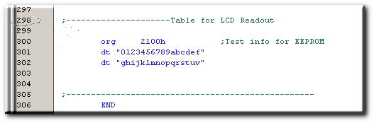

Mike,
further to my previous post, here is the actual information from the asm file with regards to the EEPROM data, as well as the output from MPLAB if when I programme the chip using MPLAB ICd2.
The program code just sets up the internal oscillator to 8 MHz and loops on itself.
Thanks again,
Robert

Hi Robert,
Try using the 'de' directive instead of the 'dt' directive and see if that makes a difference.
        org     0x2100
        de      "0123456789abcdefgh"
        de      "ijklmnopqrstuvwxyz"
Mike,
I tried with the DE directive but it makes no difference, although the HEX file is slightly different, as seen in this dump. As well I get the same "Ok" message at the end of the transfer but the EEPROM memory block still the overwritten data in the first 8 bytes of the line, not going over the end...
Robert
  • 16f886Test_DE_Directive.HEX.txt
Robert,
I just setup an '887 bootloader board and verified there is some type of problem. Let me investigate.
