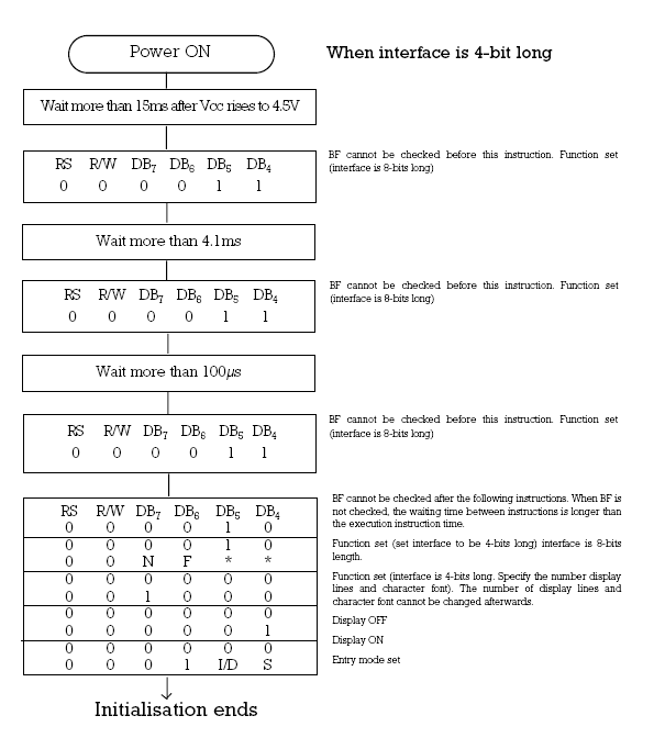

I've been scratching my head for a couple of hours, and have looked online for solutions, but everything I find is in the "C" programming language. I'm not able to initialize my LCD, and I don't know why.
Try increasing the delay150 to 500. If that works, incrementally decrease till it doesn't work, the bump it back up 50-100msec.
Most of the LCD initialization problems I have had have been due too short of an initial delay prior to the initialization string.
Isn't the delay mentioned in the protocol for initialization?
You've got to init the LCD in 8bit mode first because they always default to that.
What you're doing in LCDinit is starting with a 2 nibble command. That de-synchs the 44780 so every byte you send after that is 1 nibble out.
First send a single nibble to init in 4bit mode.
After that you must send every command and character as 2 nibbles.
And check your E pulse, the 44780 latches the new data on the \ edge of the E pulse. The / edge is ignored.

And just to be sure, through in (While in Bank1 ) "CLRF ANSELH"
My guess is that you LCDs are different makes and the problem will swap over if you swap LCDs. Some of the newer LCDs are not as fussy about the initialization sequence as the older ones. I've attached the required initialization sequence. As you can see (and as pointed out by RB) only 4 bits should be sent until initialization is over. Also note the required delays.

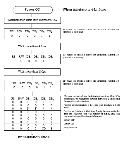

No problem.
Edit, may as well attach the data sheet.

You should really get the datasheet for the Hitachi 44780 too (that's the LCD driver chip inside the display). The init sequence shown in RS datasheet that Pommie posted is not exactly the same as the example in the 44780 datsasheet but like Pommie said most of the LCDs are not that fussy.
Occasionally you'll get an old LCD with a slow 44780 clock speed that needs longer delays in the init code. I've pulled a couple of 16x1 from old 1980's fax machines that were like that.

Hey guys, don't mean to bump this thread (I've been out of town for the last little while).
I played around with it last night, and this solution worked:
