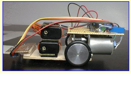

Well at the moment its pretty dull, base + mounted motors (from swallow.co.uk with encoders)

only the motors
Not the best pic in the world, my real camera was ooa. But is shows the size of it. Eventually it will be a micromouse, but i want to work on the drive system first.
pittuck said:
only the motors
looks cool...
