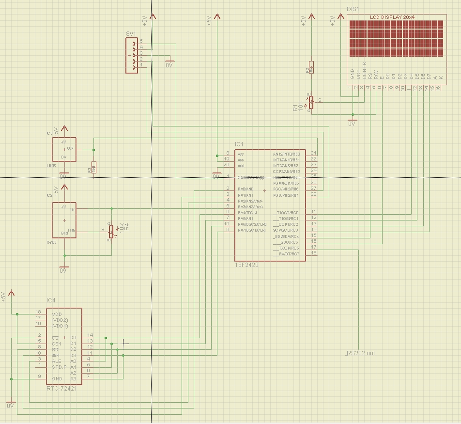

Hi all,
Sorry if this is a dumb question but if I wish to use AN12 (RB0) and I set ADCON1 (PCFG3:pCFG0) = 0010 as shown below this doesn't preclude me from using the other pins which will be set as analogue channels as digital i/o?
Thanks in advance for any help.
My guess is no. If you only want one channel you must use AN0, but of course I could be wrong (in fact I usually am!) :-(
Pins that are configured as analogue work fine as digital outputs but always read zero when read. This can cause huge problems with RMW type instructions.
There - I told you so - wrong again !!!
You can use it it just not easy Is that not right Mike ?
You just cant do a (bcf or a bsf) but can set it High with portB or latb = b'11111110'
Or am I crazy Lol

bcf or bsf should be fine, since you don't care what RMW does with the remaining bits (it will read them as 0 and "write" them as 0).
It's RMW instructions like incf, decf, incfsz etc. that you'd have the real issues with.
Is there a particular reason you're using an12 instead of an0 for your analog input? You already laid out a PCB?
Unless you need to use the remaining pins as digital inputs, you should be able to use an12 by itself.
I want 7 dedicated pins on a port for a RTCC. I can modify my cct so that my RTC is on portC, my lcd on portB thus I can put my analogue input back on RA0 where it was before I connected the RTC chip.
Thanks.

Angry Badger,
Why don't you save yourself a lot of pins and use something like a PCF8535 on I2C?
Just a thought :rolleyes:

gaspode42,
I'd not heard of a PCF8535 until you mentioned it. Just looked at the pdf. It looks a bit complicated for my level of understanding and I haven't dabbled with I2C yet. Something for the future.
