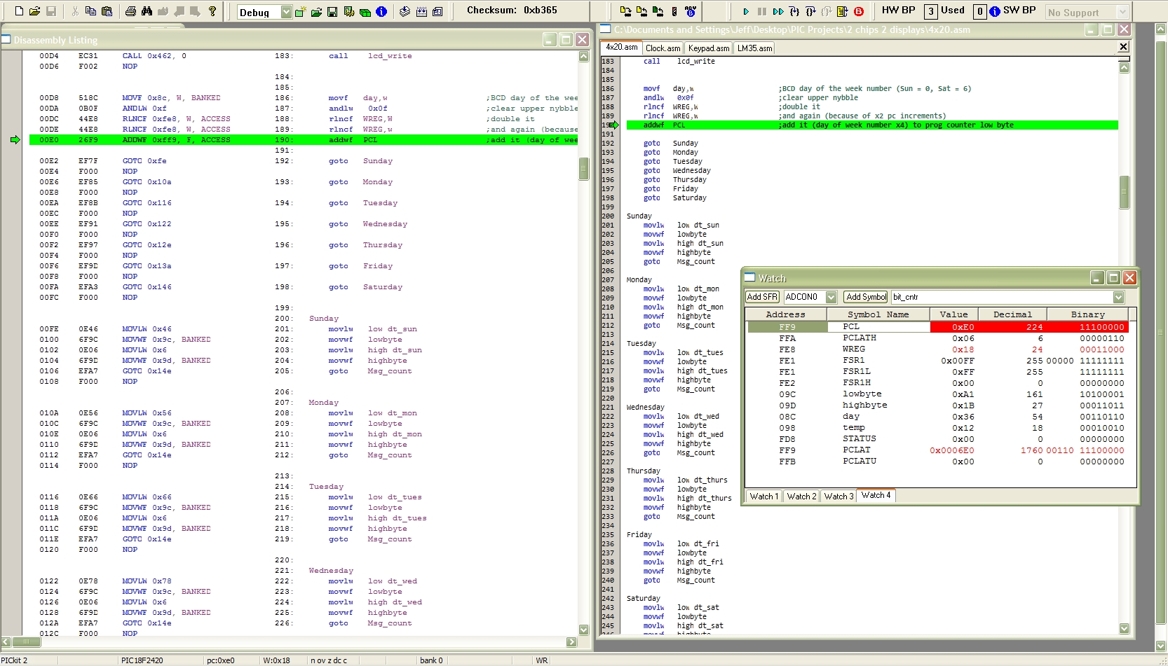

I need some help with my program. My program doesn't jump to where I think it should when I add an offset of 0x18 to PCL, in fact the program hangs.
I add the value 0x18 to 0xE0 (PCL) and expect to go to 0xF8. If you look at the attached screenshot I think you will see what I am trying to do.
The prog does a 'GOTO' ok to all days except Saturday. I can't see what's different about that one.
   movf   day,w                  ;BCD day of the week number (Sun = 0, Sat = 6)
    andlw   0x0f                    ;clear upper nybble
    rlncf  WREG,W                   ;double it
    rlncf  WREG,w                   ;and again (because of x2 pc increments)
    addwf  PCL                      ;add it (day of week number x4) to prog counter low byte

Your code will jump to 0x6F8 as PCLATH contains 0x06. Clear PCLATH and it will work as expected.

I tried Pommie's suggestion and it appears to work ok. Thanks Pommie. I'm sure I tried clearing PCLATH before but still had trouble, I must have been screwing it up elsewhere as well! No suprise there :)
