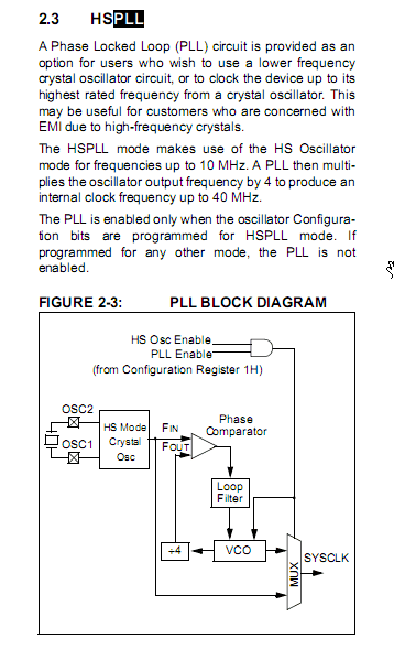

Hi all,
What should I do to operate a 18F4431 at 40MHz?
I tried using a 10MHz crystal with 2x22pF caps with the "HS oscillator, PLL enabled (clock frequency=4XFOSC1)" but it didn't work [I blinked an LED with 1Hz and the timing was all wrong].
I used a 4MHz with the same option but it also gave me the same result.
The pic works fine with a 20MHz crystal at HS mode.
What have I done wrong? Here is the bit configuration that I used
Regards

Thank you both for replying. I am using mikroc pro for pic v5.61
void main(){
     TRISC.F7 = 0;
     while(1){
              PORTC.F7 = 0;
              delay_ms(1000);
              PORTC.F7 = 1;
              delay_ms(1000);
What speed does the LED blink?
How does the compiler know what frequency you are operating at?
BTW, the code you posted will produce a 0.5Hz flash.
